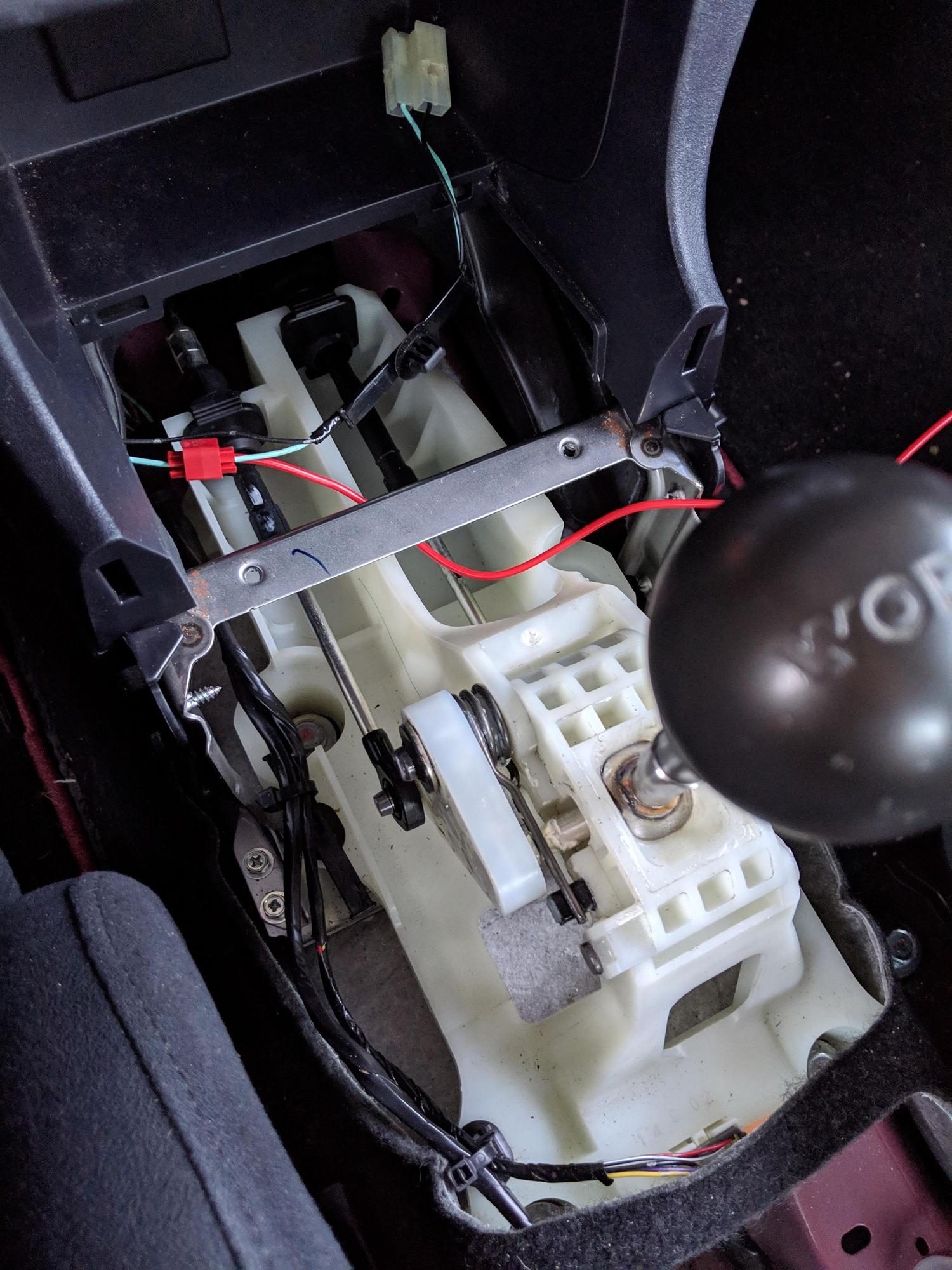

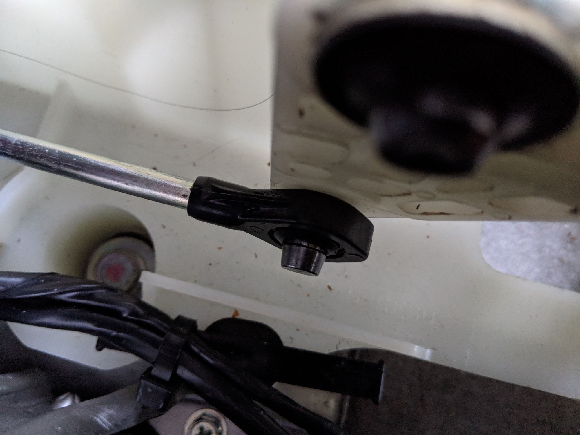

I was having a lot of trouble figuring out what to do without the pictures. I kept thinking that I was suppose to pop out the right cable under the shifter and twist it. I thought the left cable was secured by a locking ring similar to the two shifter nuts but as mentioned above, they're not secured with anything. You just pop it off with a flat head screwdriver. I can't really understand why they would design it like this but after that you can just twist it either direction, put it back on easily and it'll work.
Rattle is completely gone now and my shifting feels more responsive with less play.
I uploaded the picture on Imgur, hopefully they don't get lost with time.
https://i.imgur.com/gBYNQls.jpg
https://i.imgur.com/Ke6dzfL.jpg
