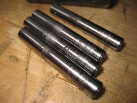

My clutch just started to slip at 14k miles, I have a 3rd gear grind at high rpm and I keep seeing the center diff failures posted on the forums so I just wanted to find out what the problem(s) might be.
As you have all seen the stock clutch just not up to the task, so I just need to replace it.
My 3rd gear grind is from a worn/bent 3-4 shift fork, (It’s done it since day one and I bought the car used) the fix is a new fork.

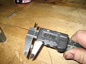

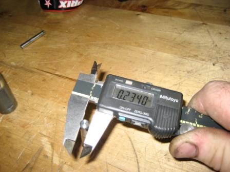

Now, I didn’t have the center diff fail, I just had the transmission apart so looked around, I found that the four spider gear axles that hold the spider gears have a hole for the lock pins and its way to large for the lock pin.. Take a look.

From what I can see the spider gear axle lock pin hole is to large making it cut the locking pin and then it just falls out. If you look at the last photo you can see the spider axle pin is just chewing up the lock pin.
So center differential will always break over time even if your car is stock ?
Old Sep 10, 2009 | 07:44 AM
GasHead's Avatar
Joined: Jul 2008
Posts: 53
From: Houston, Texas
From what I can see, Yes at some point and time they will break.
