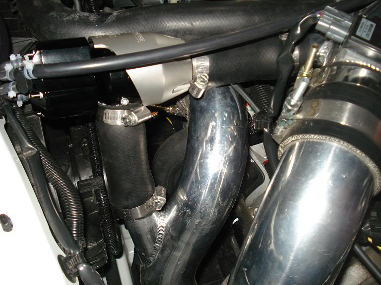

Just finished installing the Synchronic BOV by Synapse. Here is what happend during install. I have the AMS CAI and UICP/LICP, when installing I realized the Silicone tubes from AMS was to large for it to fit properly on the bov. Even if I used a worm clamp or t-bolt clamp there would have been a gap for a leak it just didnt fit right even with the clamps. So inorder to fix the problem I used the STOCK rubber tube that was connected to my stock bov. If your not sure what im talking about its the rubber tube thats about 1-2 feet and bent in someways. Anyhow I cut this tube in peices to make it fit the Synchronic BOV. I then attached the vaccum lines and T'ed off Port A and Port B on the Synchronic BOV.
After installing I took my EVO out for a spin. On WOT car feels smooth no surgeing or hesitating/jerking the sound even sounds good for a recerc bov.
On Half throttle/lightly giving it gas and increasing speed I noticed the BOV surging, and the car jerking/hesitating. Im pretty sure this is from not having a tune after BOV installation. If im wrong please correct me.
Here are some pics of install:

Granted ive got an 8 not an X but after i had mine installed the driveability was equal to or better than stock with no tune.

Almost forgot while driving around and testing etc. etc. No codes or CEL's popping up.
If installation looks incorrect please tell me. However im pretty sure I installed it correctly. I am a bit worried with the Half throttle issue im having, but then again Im pretty sure this is due to not haveing it tuned after install. Hopefully I can get my EVO tuned after I get back from the field.

At partial throttle, this bov flutters a little. I dont think it's a big deal though. Probably the sound you are hearing.

I realized that around 10psi accelerating the car DOES jerk. Hopefully Devin from Synapse can give some input on that.
to OP: where did you source the "tee" you used for the line a + b?

Devin from synapse here!
to the OP the piece you used to T or Y off the line loks a bit odd.. i think using a Y fitting would give more a more equal balance of vacuum to the valve ports.
Inci9nito99 try loostening the preload a tad.. im assuming you are running on ports A+B
Devin

^^ I sent in mine to get the c-port removed by you . the preload was never touched, but I presume the only "fix" around the situation is the obvious, loosen the pre-load.
ps. where can I source a Y fitting, cant seem to find one ANYWHERE that is non-quick disconnect. :strange:
