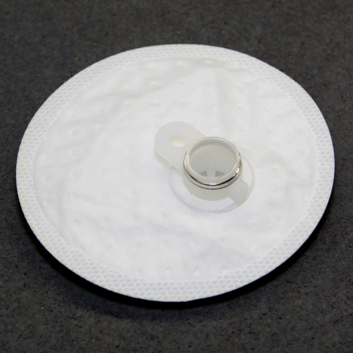

Also, this round filter sock might be a better fit? Probably would be better than the standard one that comes with a walbro for most kits anyways!
FFS-040G

Hrm, it is 121mm long...how long is the standard GSS342?

That round sock would be a great fit for the X pump housing, very similar to stock in design.
