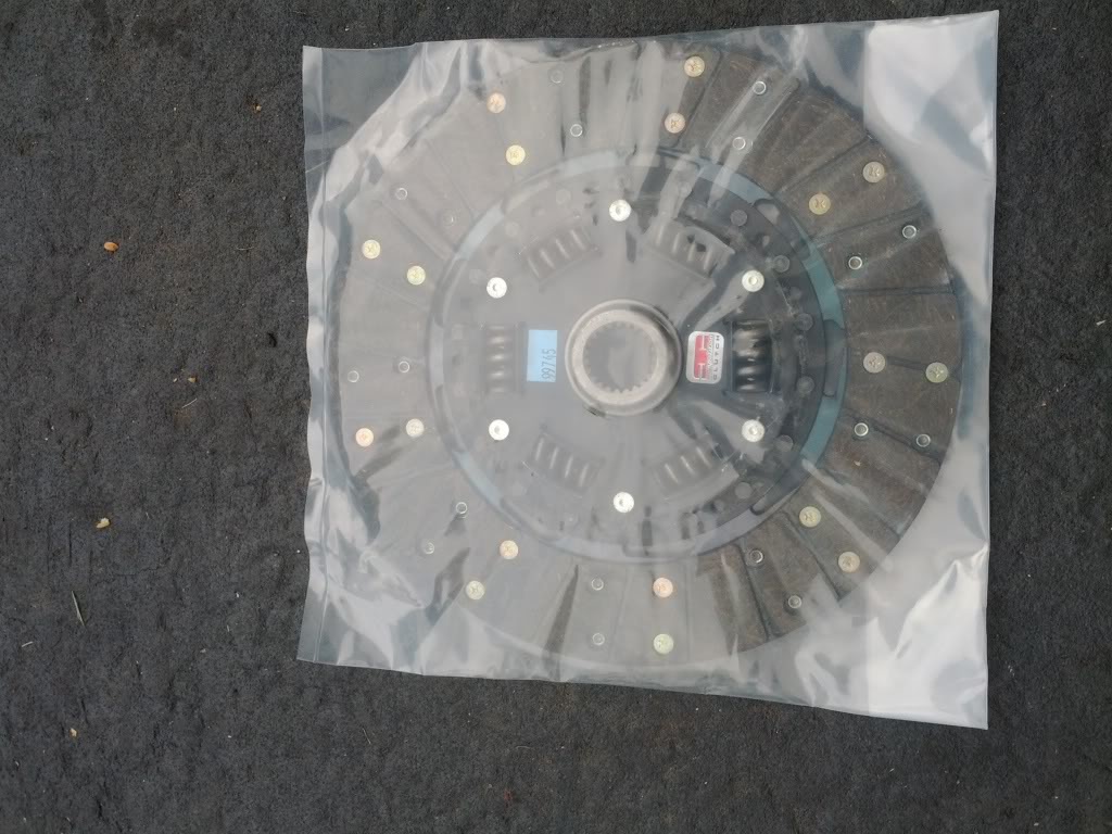

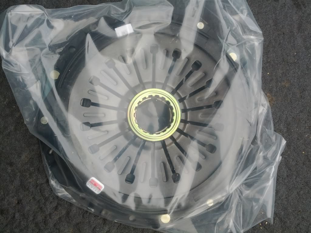

Competition Stage 2 Street Series 2100:
I will update this thread as more parts start to roll in and the rebuilding process goes in. Again, MAP is the way to go
