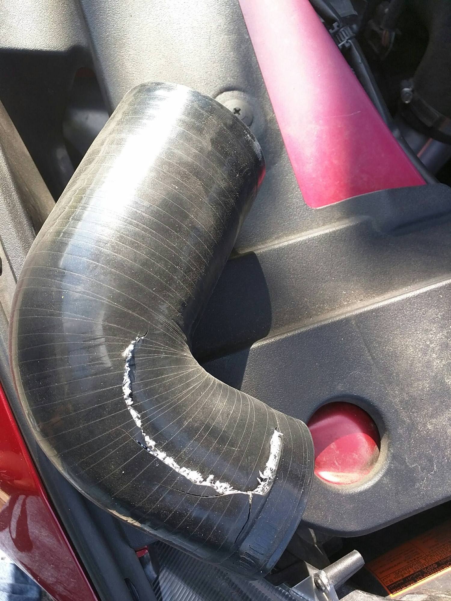

found this

Originally Posted by MisterRegato
found this
You should rejoice that it's not something serious. A BW EFR 7163 on stock block is something I would never do to my beloved Evo, although the masterful tuning done by CBRD might keep you safe for while.
found this
Excellent, a simple fix then! I figured it was a blown coupler. Glad it isn't more serious.

Originally Posted by CBRD
problem is these couplers are on back order from our supplier- working on this for andrew now
cb
is there anything that is reinforced?

Had this issue when my mom was in town lol, as soon as I read that you heard a "pop" I knew it was a coupler. I have never seen a coupler with a hole in it though!
