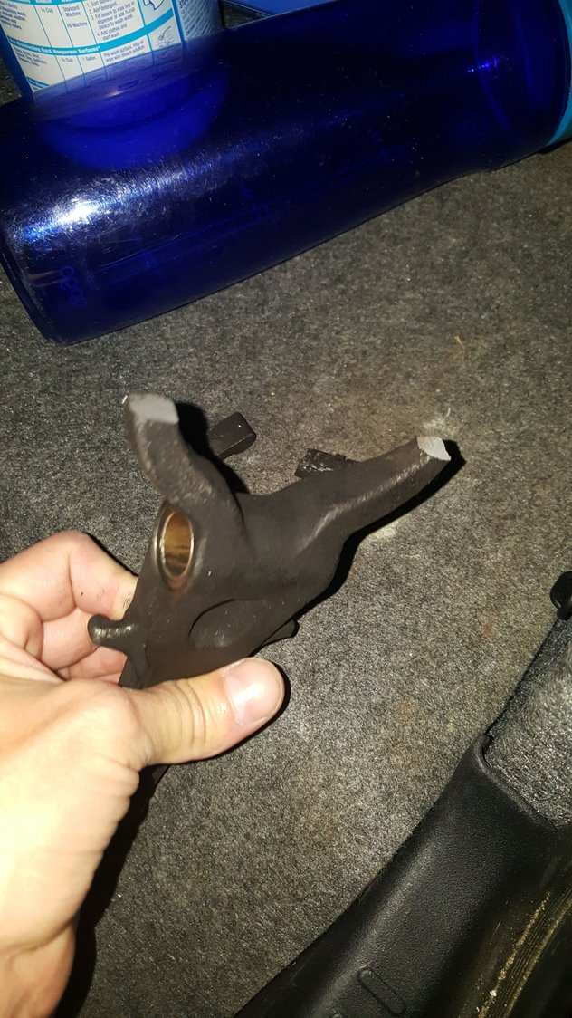

Hey guys I need your help, I was driving my car on the freeway, went to shift gears and my pedals collapsed to the floor. Towed it home check the master cylinder for leaks and by the pedal and there was no leaks. I was able to pump the clutch up and it held pressure but wouldn't engage. Not sure if there's air in the line. I replaced the clutch with a exedy stage 1 heavy duty clutch kit less then a year ago. Thanks a lot

Nope it's not broken. They said they think the fork is broken

It may be a broken throwout bearing and/or the collar. When you do replace your clutch I highly recommend the ACT MONOLOC.

Can you check the fluid level just to be sure? When my cmc broke it didn't look like it was leaking until I took the brake booster out and saw it close up. The clutch forks are usually pretty strong and rarely break. Can you have someone push the clutch in while you look at the slave cylinder under the hood?

check the actual fluid in the salve cylinder pressed in

So some how I broke the clutch fork. Thanks for all info

DAMN...!!!!! Is the first time than i see this..!!!
