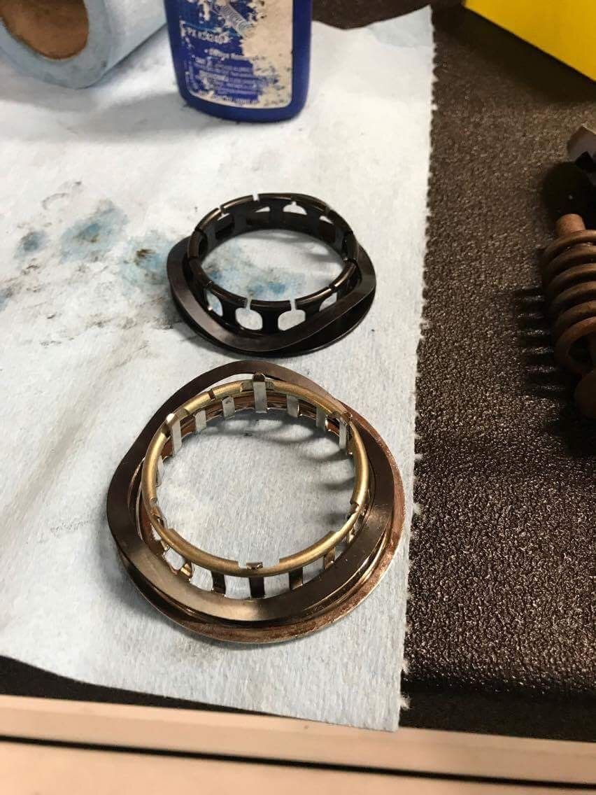

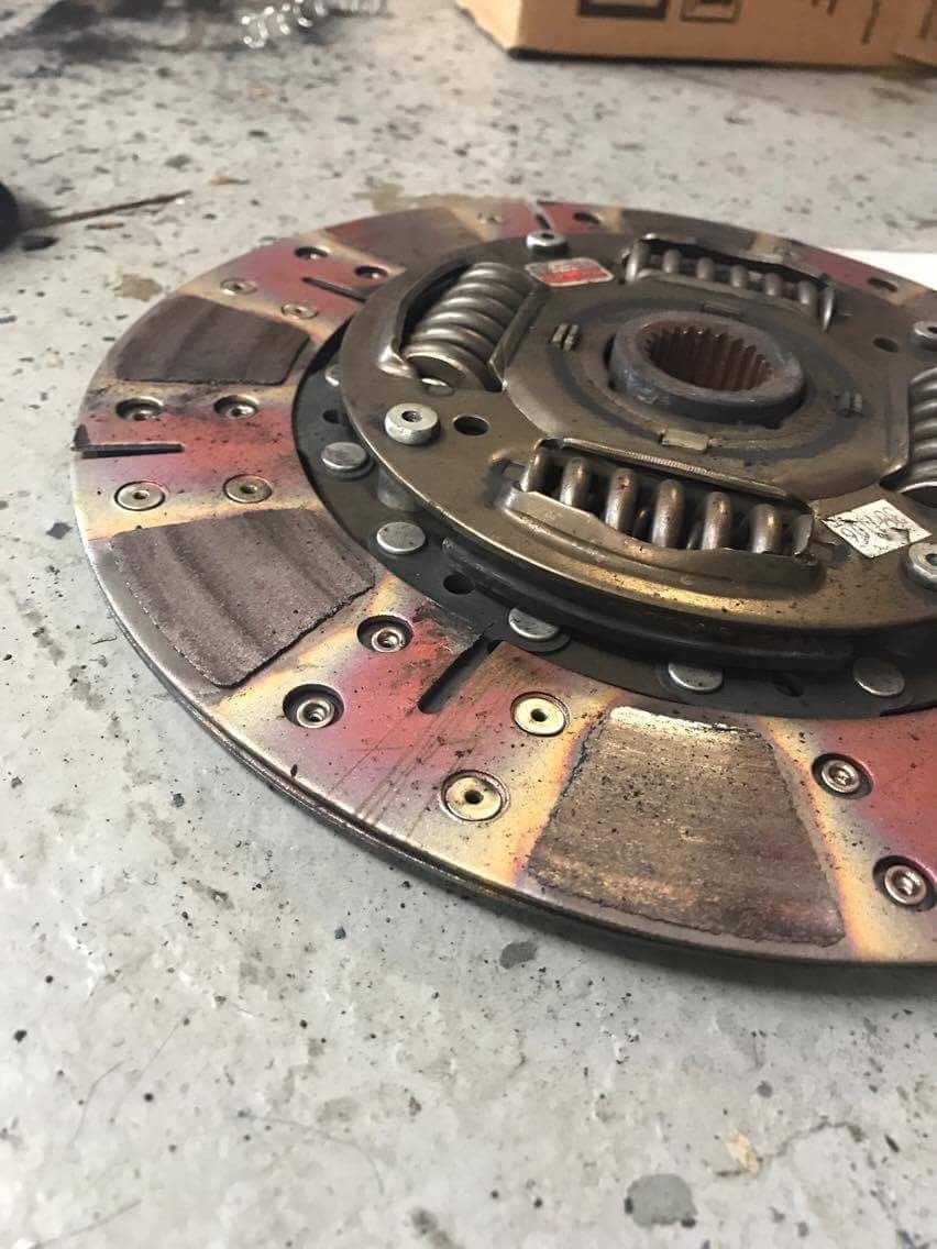

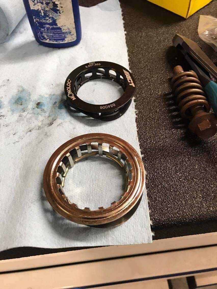

Well guys, I found the culprit.
clutch disc was warped all along and it was causing a few things to not act right. I would NOT recommend a Comp stg3 to anyone.

It's not really warped, just worn out. Every single one I've pulled wears like that.

It's definitely worn out.
