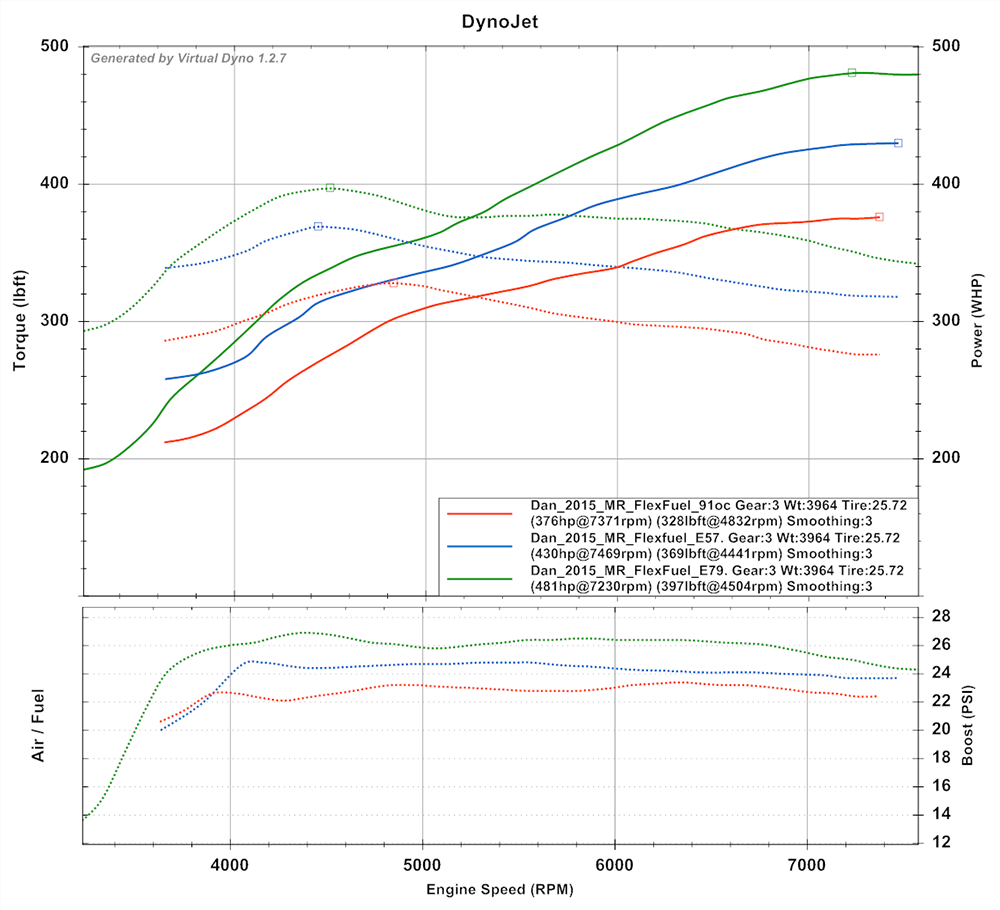

If it was my car, I would go E85 and tune before the cams. You will see a huge gain in just that alone. 80whp or more. If you still want more, cams.
Here is an 18k I did years ago. 91, E57 and E79. You can see the gains. Ignore the spool. I was tuning on the street and not going WOT very early.
18k I did
No doubt those power gains are awesome, which is why I'm eager to see if I can get the flexfuel tune. However, I'm looking at a 3 hour drive one way, and a flexfuel tune is around $900 I think, so I was thinking ahead and figured do the cams, springs and maybe head bolts and THEN pay the $900 for the tune. I know myself pretty well and will likely want more power later, so I'll be out another $900 for the second tune.
