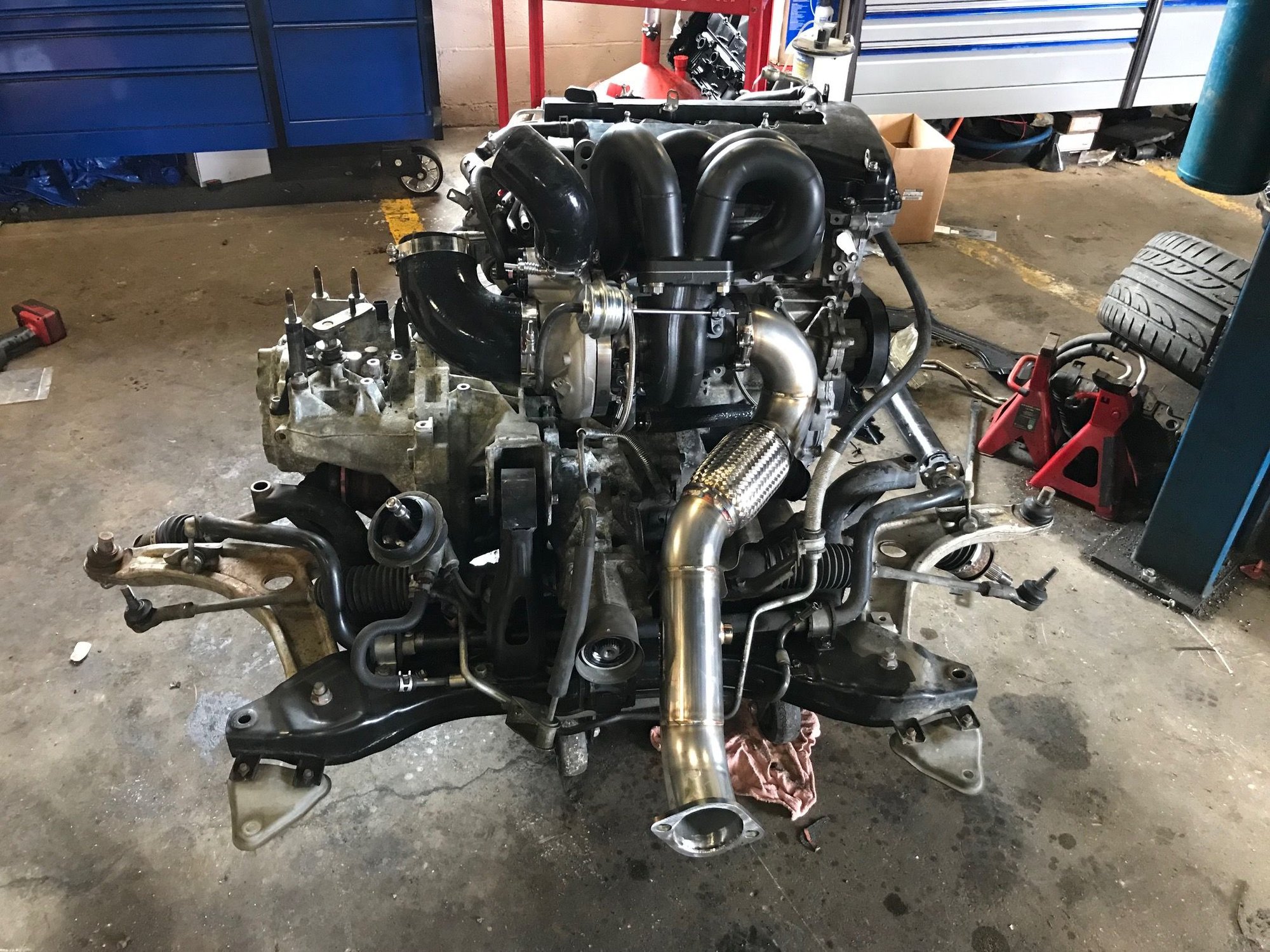

On the other forum some asked for pics, this is all I got, don't know it'll do any good.
Also the second pic shows the line that I was talking about that blocks the way to get to the clutch, hence why they said they'd drop the motor to get to it.

Also this was before we decided to go with a Turbosmart acuator might I add.
