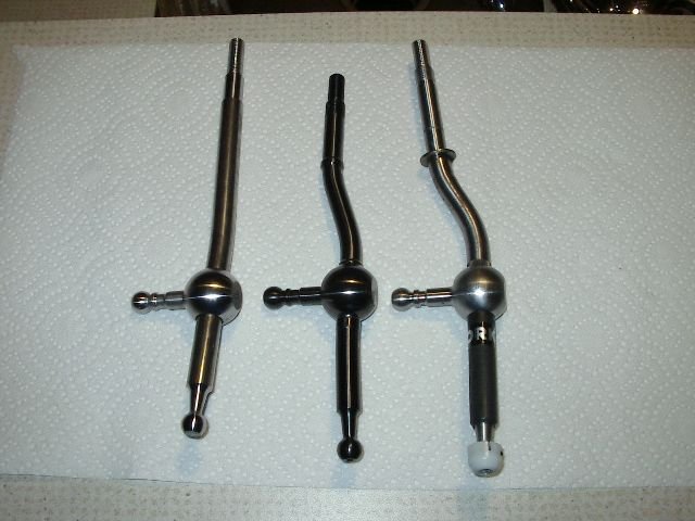

The short shift kits for the GSR only reduce the throw about 25% so without going out to the car with a ruler, I'm not sure anyone can really help you figure that out. If you pull the boot up you can visually check pretty easily. The stock unit is straight and the Works / Torque Solutions / TWM units are kinked.
Left to right - Stock, TWM, Works

Been looking at different images on the web and looks like car is fitted with a standard shift lever.
Going to buy torque solutions short shifter for RHD car , which are straight and not kinked like the LHD shifter.
