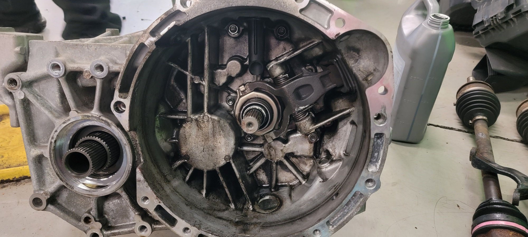

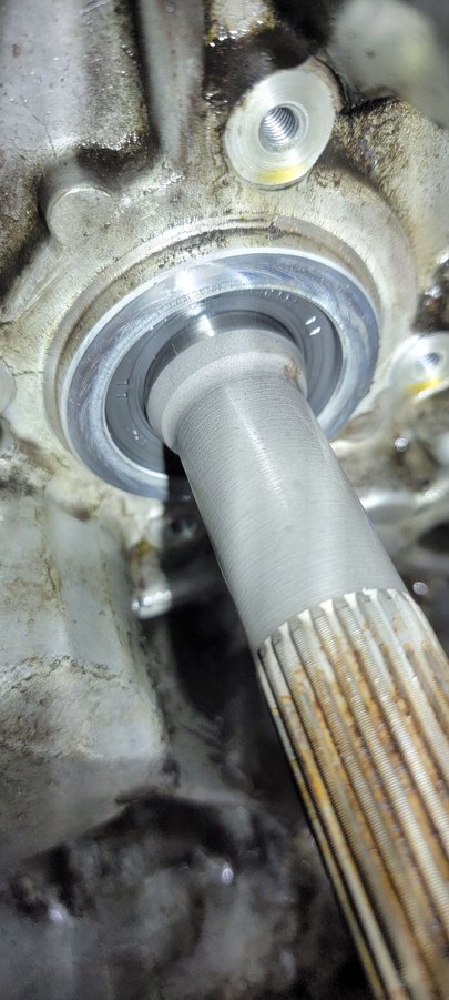

Photos from teardown last week. Says input shaft is bent and isn't seated correctly.
Lawyer up, IMO that 100% sounds like damage from install.

are we looking at the seal not seated properly?
