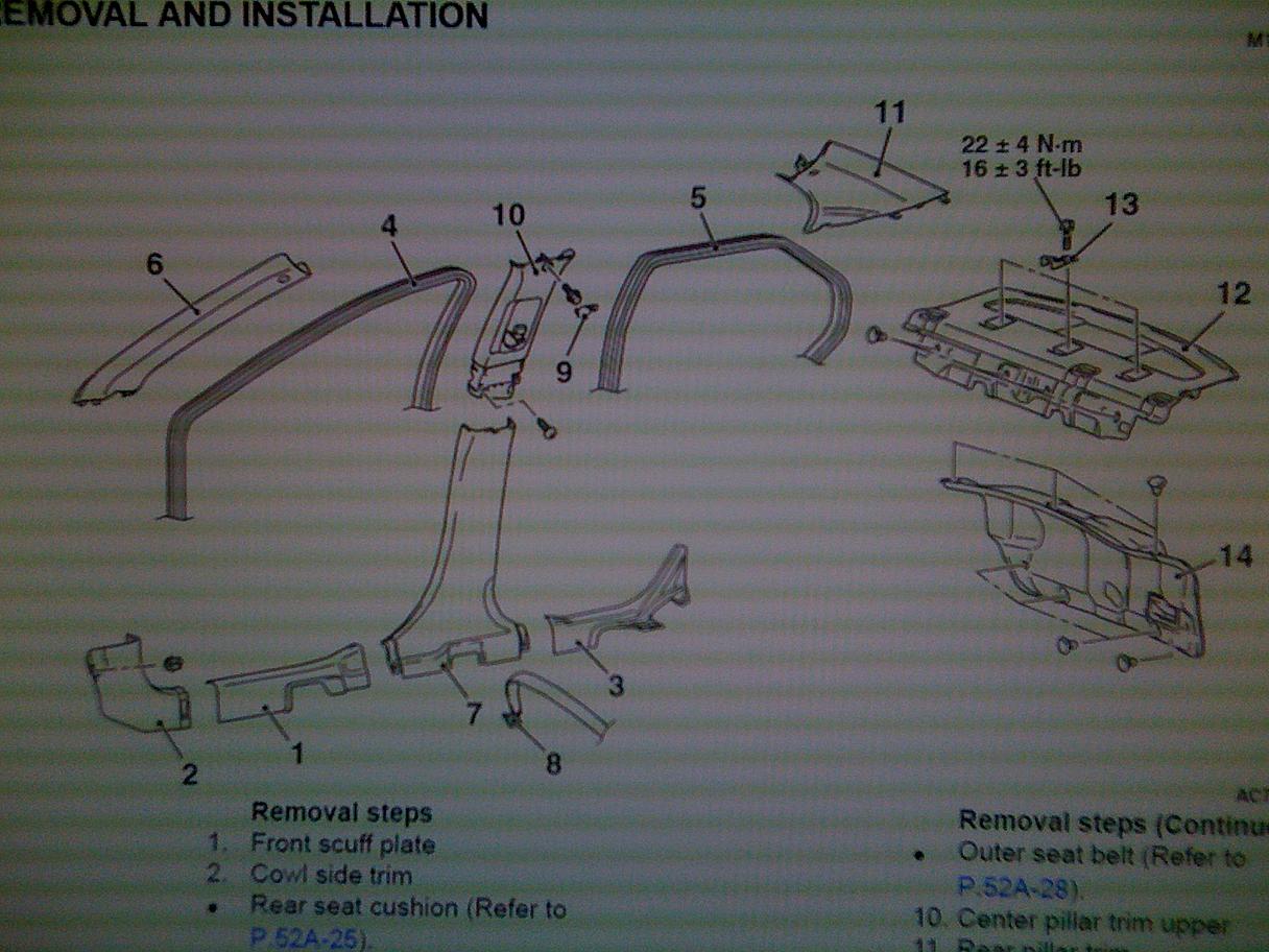

Has anyone removed the kick panels on a 2010 evo? I like to remove all the panels up to the seat belt harness and wrap them in CF.

Has anyone removed the kick panels on a 2010 evo? I like to remove all the panels up to the seat belt harness and wrap them in CF.[/QUOTE]
something like this ? should be very easy.

They are held on by plastic clips. Start by grabbing the one by the driver's side recaro seat and pull. Getting them off is easier than snapping them all back into place.

Thanks for the picture it should help.
