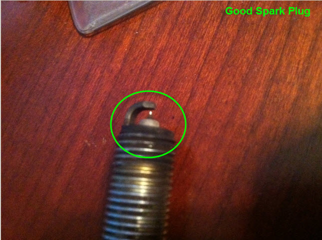

So it turns out 1 of my recently installed NGK Spark plugs(installed a month ago) had an issue. The sleeve around the diode broke loose and was sliding down and cutting the spark off. Just thankful it was a cheap and easy fix.
Heres some pics so you guys can see what exactly the issue was.

theres lots of info on this issue. Back your tune off a bit, youre probably detonating. Is your check engine light set to flash on knock?

^^^ if your knocking parts of your plugs loose you have a detonation problem--need a retune before you buy a motor.

I do not have my check engine light set to show when knocking but my accessport shows that I dont have a problem in knocking. Is it possible that it may have just been a plug with a manufacturer defect? If you can see my signature with my list of parts, Im making 352 to the wheels on a dynojet. The shop that tuned it is suppose to be one of the best local shops for tuning. Not sure if there is a direct corralation between the power put down and a "safe" tune. But I see people with similar set ups making more power. Thanks for the help guys!

Make sure the plugs are gapped correctly.. I was robbed off 20hp on the dyno in my last car because over time the plug gap increased

You could keep thinking that nothing is wrong or take other's words here.
One bad batch of gas @ 28 PSI could spell D-E-T-O-N-A-T-I-O-N.
