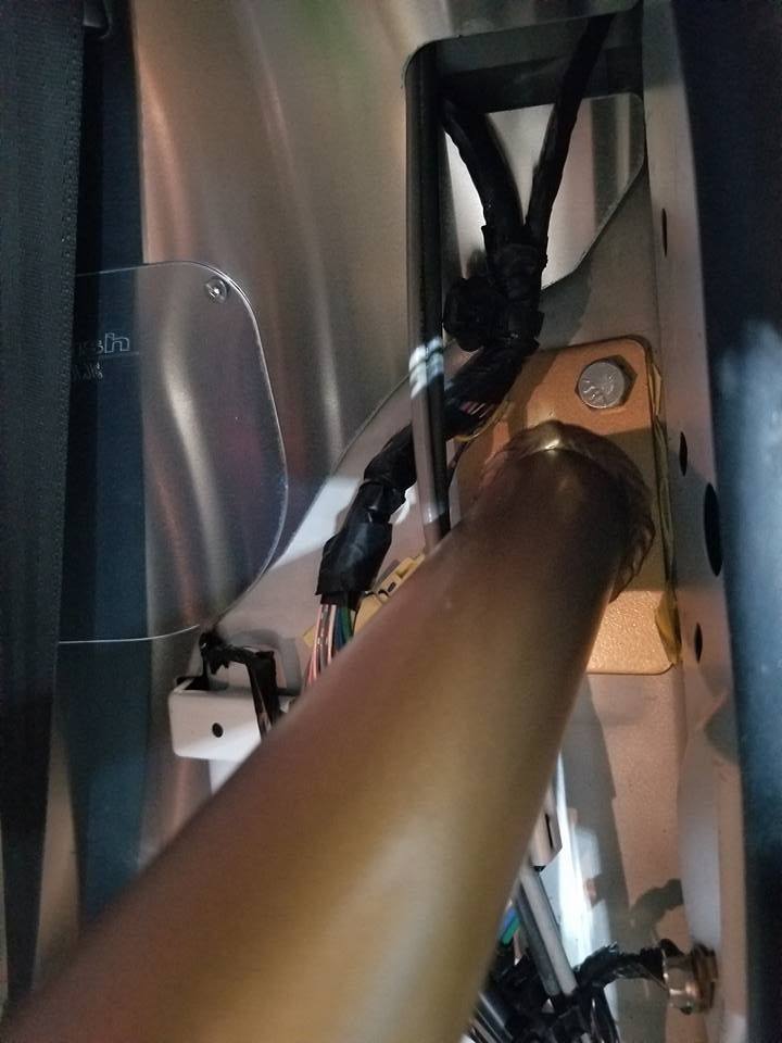

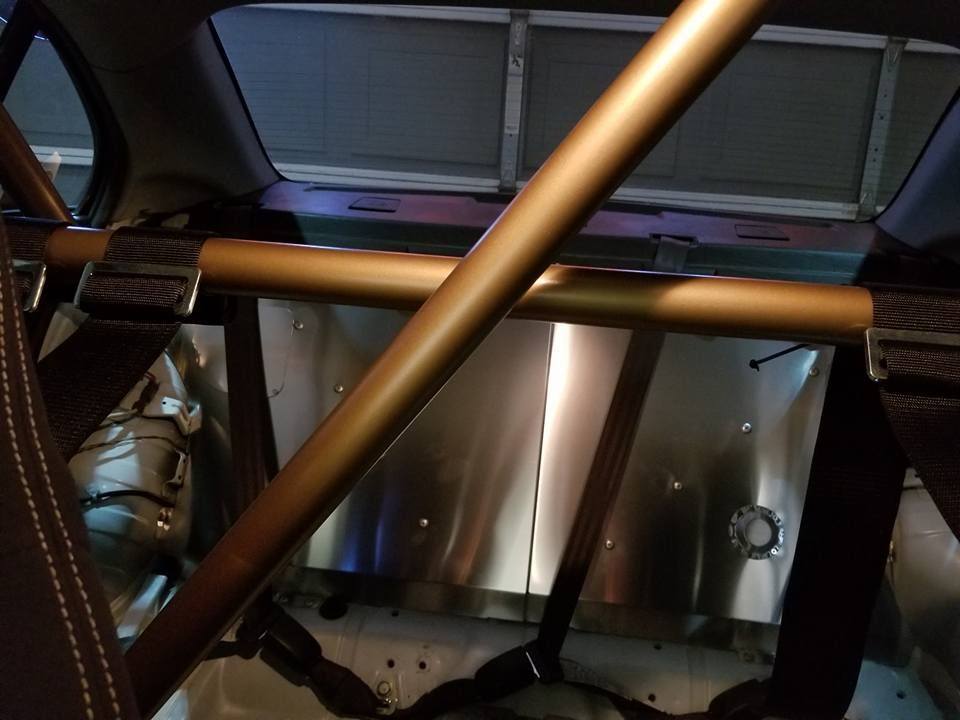

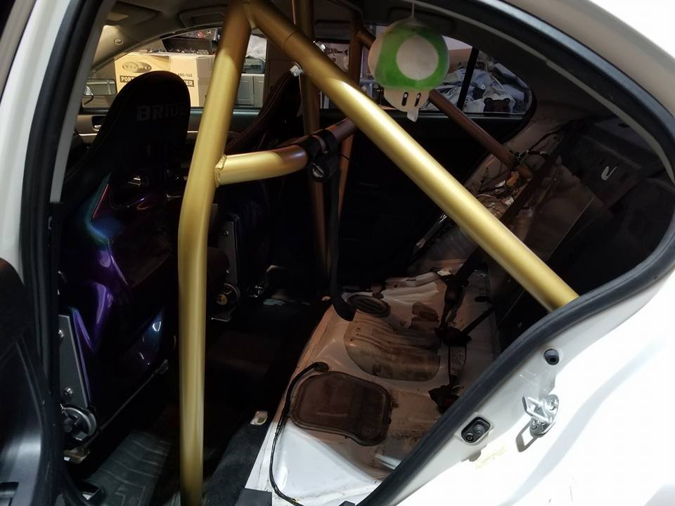

Have you done the whiteline roll center kit yet? Thinking about doing that on my car over the winter. Do you have any pictures of how the beatrush rear bulk head plate fits with your autopower rollbar?

here ya go. fitment is perfect. however, the bulk head plates does rattle a little against the trunk subwoofer. you hear it more when sitting idle. exhaust pretty much covers it

I appreciate the pictures of your rollbar and bulk plate fitment. Looks really good! I'll be ordering the bulk plate now. Hahaha
