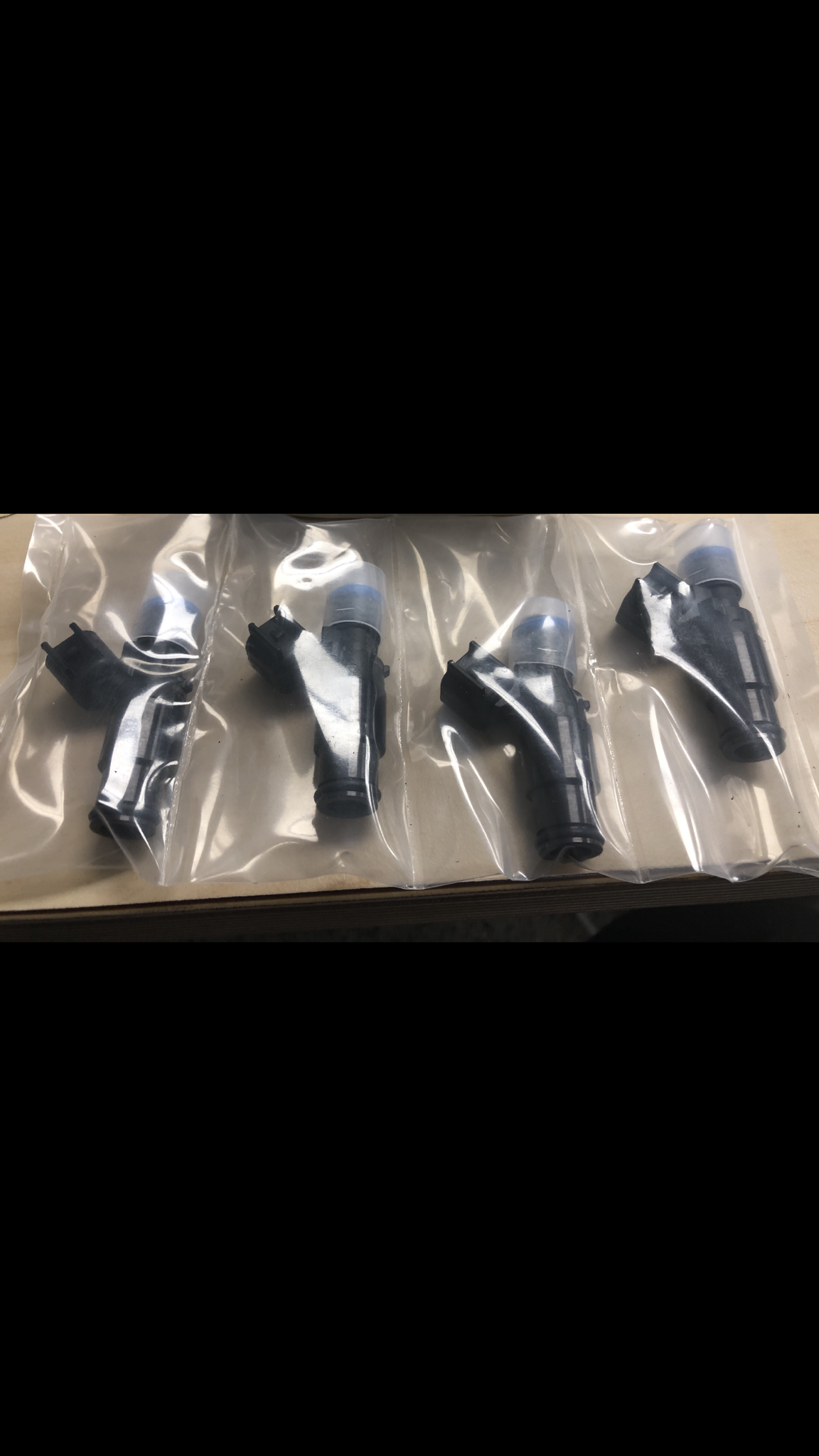

Which is the correct ID1050X injector for Evo X MR? Mine looks like the top pic and still having problems getting them flush inside. When I do a search there's 2 different looks. For anyone who has installed these, which ones do you have and were they able to seat flush? Thought I had this resolved but on the way to work CEL popped, code cylinder 4 misfire. Limped it home and the cylinder 4 injector adapter disconnected and still not enough room for these to seat down correct. I'm done shaving intake manifold at this point, it's ridiculous how crappy these sit.

If anyone else has issues, the red base with springs is not 1050. Some places just use stock images. I bought another set in hopes it'll fit better this go around.

1st one is the correct one... i had that problem too where its not flusing soo you got 2 options.. option buy a bunch of spacer from homedepot till you get the perfect fit or option 2 trim your fuel rail spacer

Sorry to double post but in case someone has problems, neither of those images are correct. In this pic, they are the plastic body blue o-ring ones.

Both the bodies are plastic. Only difference are the adapters. Injectors are exactly the same across the difference cars ID offers injectors for. Only thing that changes are the adapters they put on them.
The first injectors you had have an adapter at the top of the injector. The second set has the adapter at the bottom of the injector.
