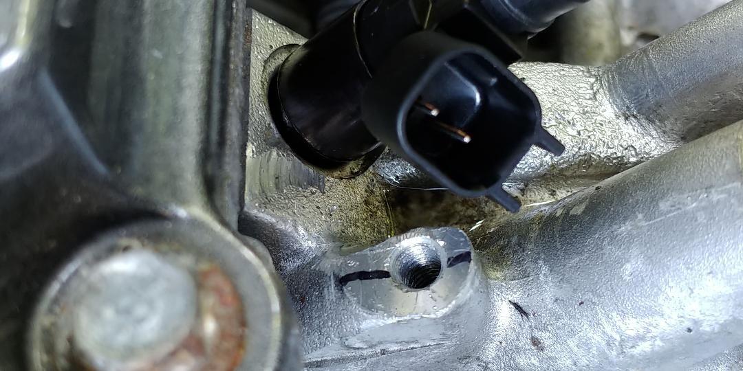

Sorry, just saw this post. bmxhotsauce has a pic of the correct ID1050 injectors, no idea how these others got out in the market because fitment was crap. I ended up wasting more money and got the plastic bodied / blue o-ring injectors and they literally dropped in flush and seated like it supposed to be. Plenty of space and nothing rubbed. No retune needed since it was already scaled to ID1050s. The only thing that was "messed" up with the funky fitting was I could smell gas in the cabin, AFR and boost was right where it should be. Once I noticed the gap I didn't want to chance things so purchased new ones from MAP, which were the correct ones. Sorry about your luck, ID never emailed me back as to why there's so many variations to the exact model number vehicle specific.

Unhappy How did you fit them?
Originally Posted by gerikivan
1st one is the correct one... i had that problem too where its not flusing soo you got 2 options.. option buy a bunch of spacer from homedepot till you get the perfect fit or option 2 trim your fuel rail spacer
I brought the same injectors off of someone from Facebook as well. Mine also doesn't sit flush because the plugs would hit the engine block. How did you manage to fit yours in?

I attempted to slowly dremel the intake manifold and decided against it and bought the correct injectors. I don't like the idea of spacers due to gas leaking out so didn't chance it.
