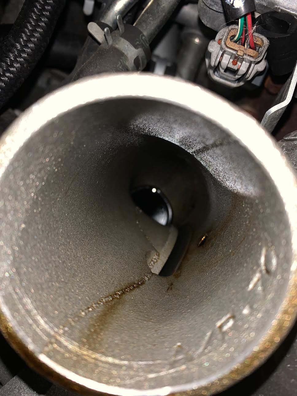

I took off the intake pipe and found oil dripping from the compressor side of the turbo, there was also a nice pool inside.
A buddy of mine with an Evo9 suggested that it could have been a frozen catch can. I went to drain it and long behold, about 10oz of water came out, followed by an ounce of oil milkshake. It probably froze solid, and the pressure prevented oil in the turbo from getting back to the crankcase. I'm just hoping at this point I did not do any damage to any oil seals.

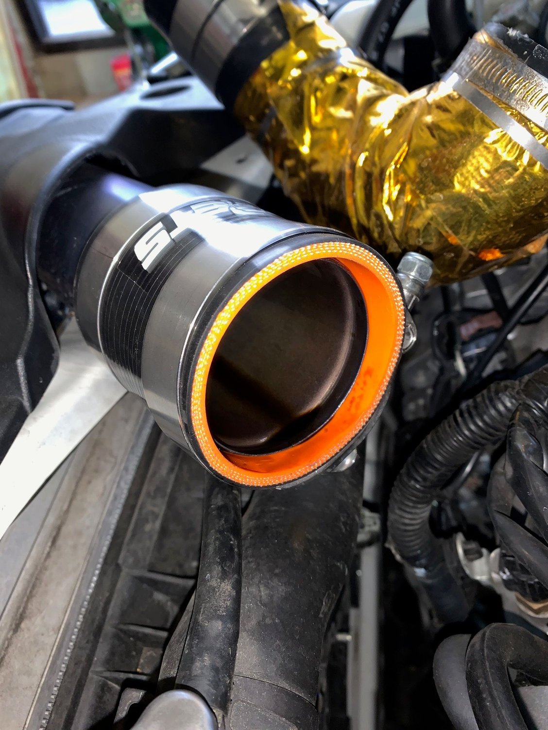

There is probably a lot of oil in the intercooler. I removed the pipe to the throttle body and luckily nothing got up from the intercooler (probably because after the event I never went over 2250.) Once I clean out the intercooler and get as much oil out of the turbo as possible, I'll burn the rest out of the exhaust and probably clean or replace the O2's after.
