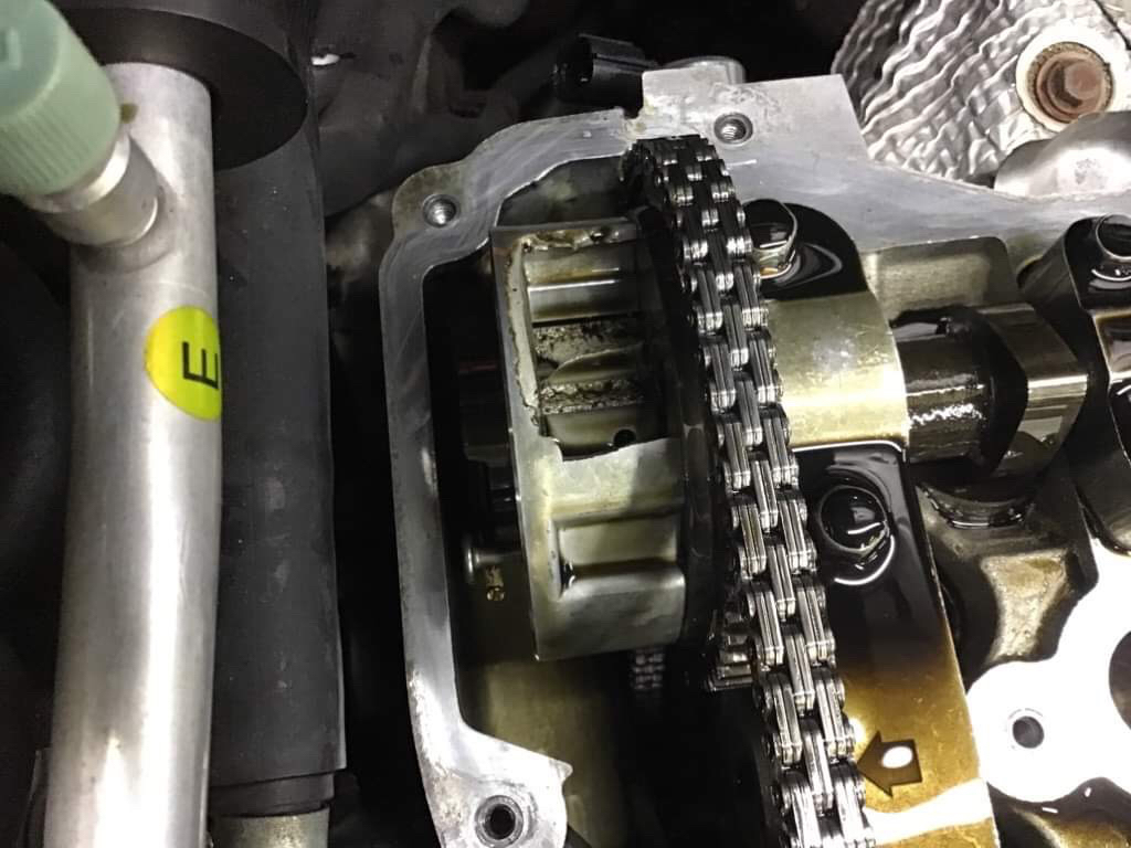

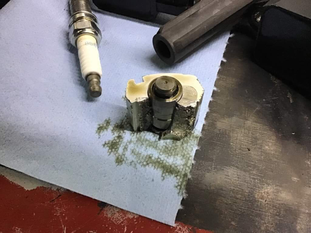

Cool story. There's a reason there's an aftermarket housing available that doesn't break, and it's bandaid for the real issue, which I know exists.
Old Feb 9, 2020 | 12:05 AM
LetsGetThisDone's Avatar
Joined: Oct 2013
Posts: 15,973
Likes: 1,629
Guarantee oil pressure doesn't exceed the burst pressure rating of the housing and break the rotor apart...
Attached Thumbnails Aftermarket cams on daily driver-photo377.jpg   Aftermarket cams on daily driver-photo399.jpg

Lmao, I show data and you say cool story. Might as well have just said fake news.
I never denied that the housings break, I denied the need to zero out mivec with mild cams and springs. It’s not needed until aggressive cams and springs.

I guess you didn't notice thats a stock cam that was run with GSC springs.
The very small change in spool up (150rpm or so) isn't worth risking that thing totaling failing and lunching the motor.
