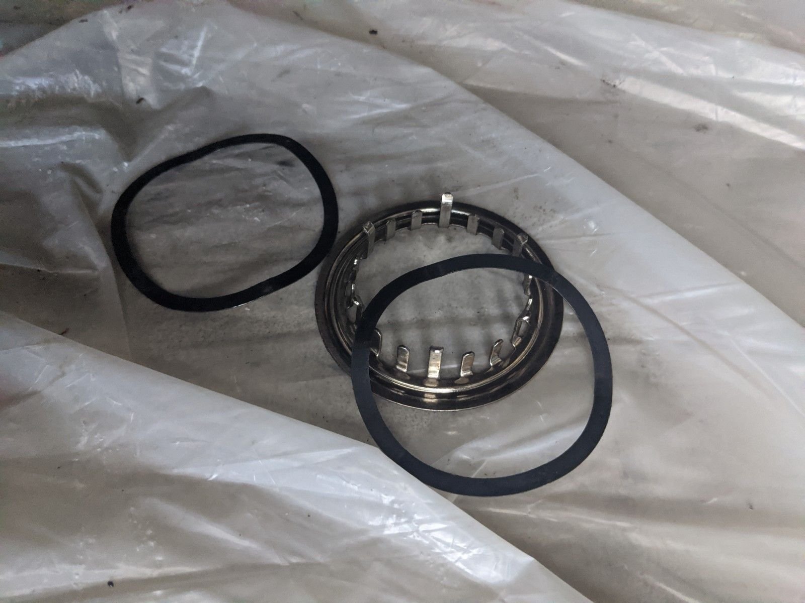

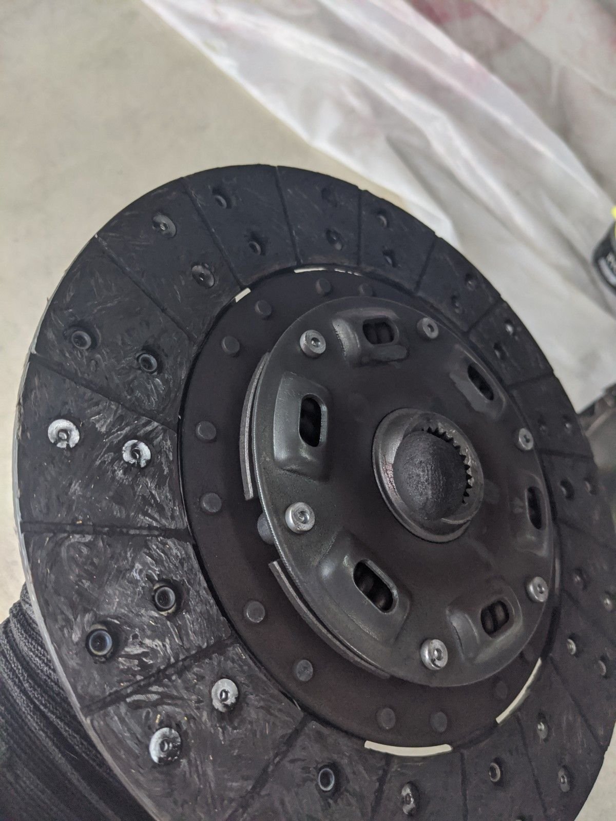

She passed inspection ladies and gents, she is now legally registered for the street. But the clutch I was given to review was flipping garbage (see pictures) lasted four freaking days. Was a blessing in disguise I guess, 3rd gear grinds a little too much for my liking. So tomorrow the transmission will be dropped off for a rebuild, I was going to attempt it myself but never done an import transmission and wanting to enjoy the car a little while I decided to take it to a shop. While I wait, does anyone have any suggestions on good clutches for these cars?

I'm using the ACT HDSS Clutch Kit with the Streetlite Flywheel in my current setup. Also am using the "Redline Cocktail" fluid mixture for the transmission (MTL & MT-90). No grinding in 3rd gear anymore.
I believe many Evo drivers use the ACT HDSS/Streetlite setup.
https://www.maperformance.com/collec...evo-x-me3-hdss
https://www.maperformance.com/collec...el-600550-2008
https://www.maperformance.com/produc...ishi-evo-x-gsr
If you DO decide to stay with the OEM clutch, you might want to get the ACT Monoloc collar, looks like yours may have been damaged.
https://www.maperformance.com/produc...-evo-x-884007p
I believe the ACT Clutch Kit has the Monoloc collar included in the box.
