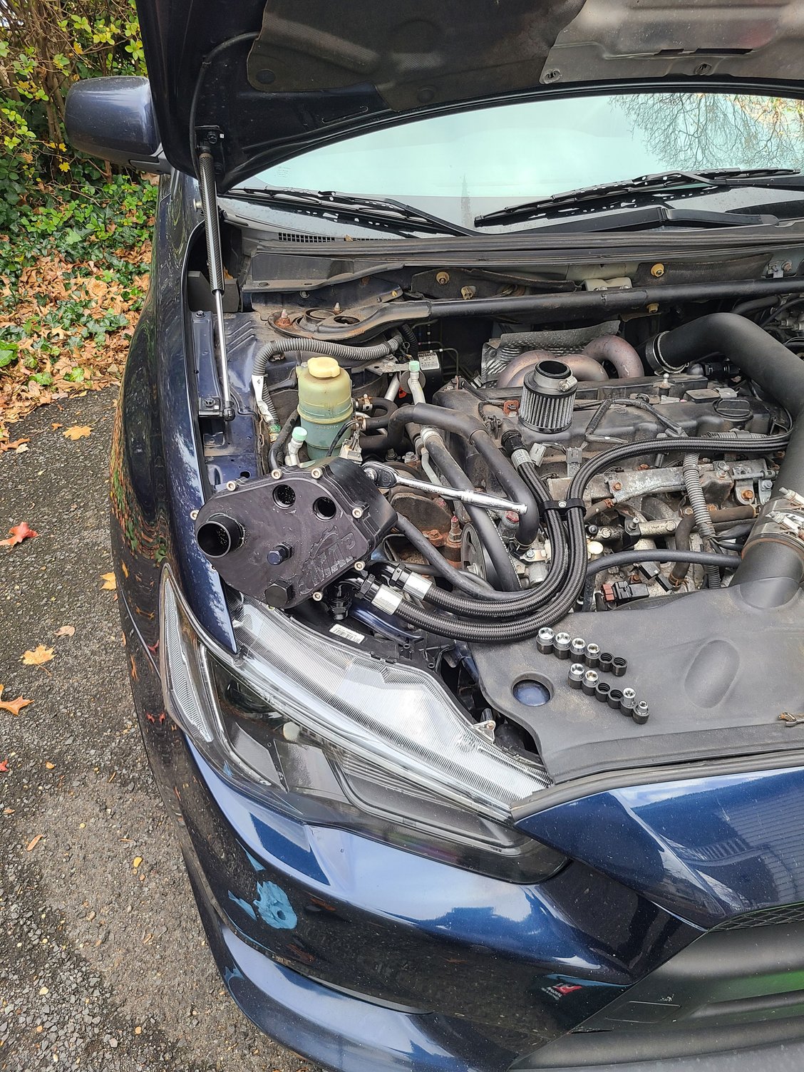

So, i got those cheap 30$ oil catch can for evo x, but i dont know where the in and out hose goes into. does anyone know? all i know is that its in the valve cover and the intake manifold.

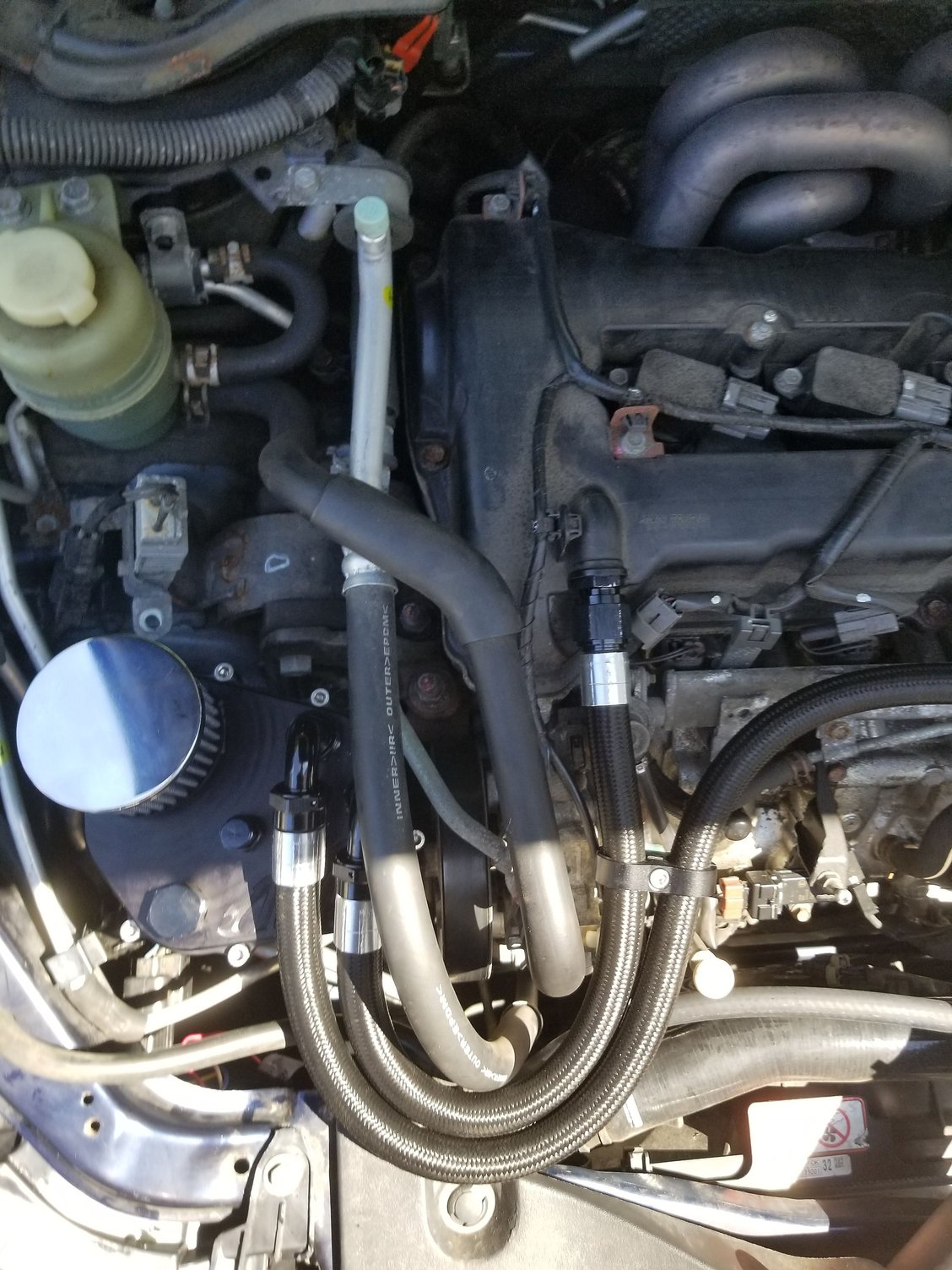

Not sure what specific brand catch can you have; the MAP catch can connected both hoses to the valve cover. One to where the PCV connection was, and the other to where the intake connects.
The hoses connect where the 2 blue arrows are pointing to.
