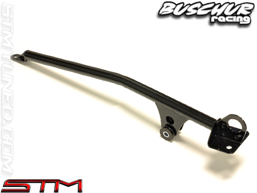

who makes that piece with the front motor mount?

Did some work today!
The weight difference here is awesome! Thanks Buschur
