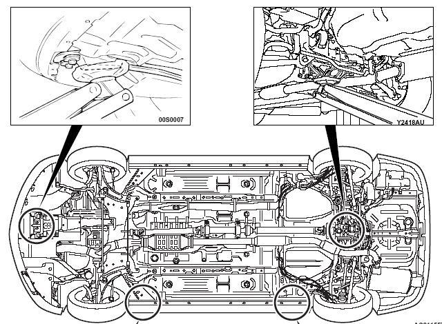

Might as well put this question here as well. As far as the jack stand points, it seems most people don't recommend using the side rails. Where are the correct places for the jack stands then?
