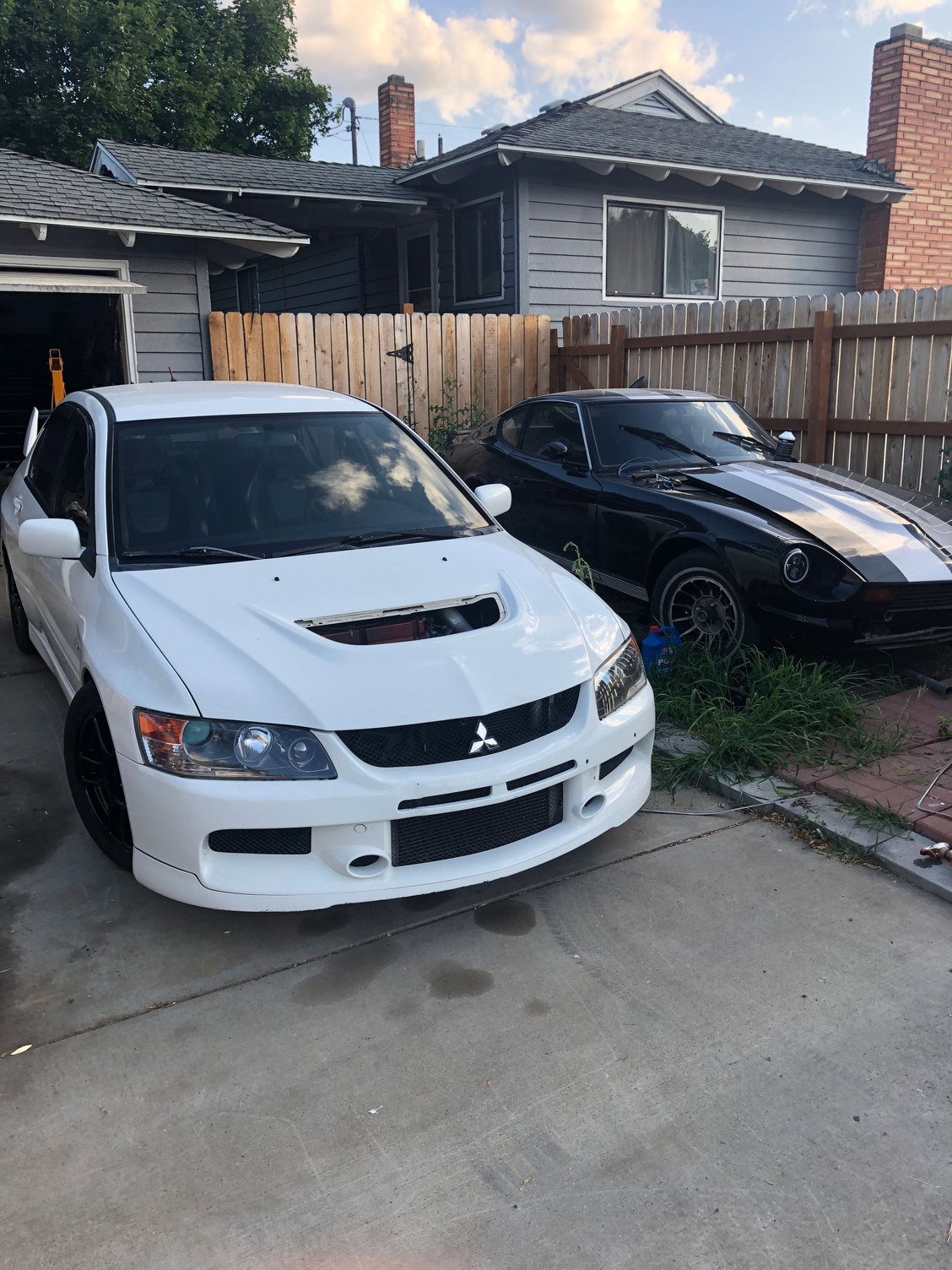

It’s a pretty solid base. Has a munch of look fast parts too. JDM rear bumper, JDM evo7 taillights, vortex generator. It’s on BC coilovers. Not my first choice but not AWFUL.
it needs work, as does every project but I can drive it without needed to spend 10k to make it tolerable.
