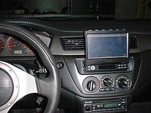

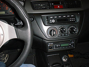

OK, I snapped a few pics. My camera is a piece of crap, so the ones that try to show the screen well are either blurry or glared from the flash. I tried some with and without a flash, but you get the idea. It looks great in real life:
First a shot of the actual PC case...I pulled it out from under the seat so you can see.
Then here is a shot with it mostly back in...with it all the way in, you see no wires or anything.
One of the screen with GPS...blurry in the pic.
A good one showing the whole setup...screen looks dark here, but it is not.
Same shot with Windows desktop...again dark in pic, but not in person.
Attached Thumbnails Upgrades for my ECU Plus-carpc-underseat2.jpg   Upgrades for my ECU Plus-carpc-underseat.jpg   Upgrades for my ECU Plus-screen-gsp-blurry.jpg   Upgrades for my ECU Plus-carpc1.jpg   Upgrades for my ECU Plus-carpc1-windows.jpg

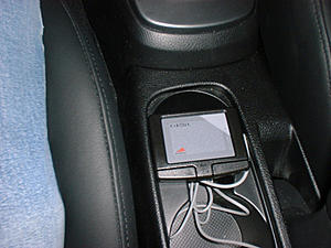

Also a backup touchpad mouse, if the touchscreen has problems (like now, since I haven't installed correct drivers yet.)
Attached Thumbnails Upgrades for my ECU Plus-screen-closed.jpg   Upgrades for my ECU Plus-backup-mouse.jpg

I'll be glad to show you guys when I get mine popped in in Jnauary. I like your set up alot man. Is that the xenarac touch screen?
Old Nov 21, 2005 | 05:11 PM
l2r99gst's Avatar
Posts: 3,499
From: CA
No, it's actually from Ebay, and it's named by a few different model numbers. If you go to www.digitallww.com, it's the same one as the DW700M on that site.
Eric
