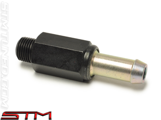

Cleaned my PCV valve, it was definitely dirty and gunked up and didn't move easily.
My new concern is that I've read you should always go OEM with PCV valves and comparing it to what's advertised by STM here:
http://www.streettunedmotorsports.co..._pcv_valve.htm
It doesn't look OEM to me, this came off my car:
http://www.flickr.com/photos/9969131@N03/8706607013/http://www.flickr.com/photos/9969131@N03/8706607013/ by http://www.flickr.com/people/9969131@N03/, on Flickr
It is attached with a 90 degree coupler of some sort you can see here:
http://www.flickr.com/photos/9969131@N03/8706608407/http://www.flickr.com/photos/9969131@N03/8706608407/ by http://www.flickr.com/people/9969131@N03/, on Flickr
Does that look OEM or should I skip the BS and go get me one from the dealer?

I confirmed that I had the correct PCV valve... by putting a new one in that I bought at the dealer.
