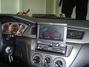

What kind of head unit is it? I previously had a sony that fit awsome with a little bit taken off the trim ring. But the pioneer that I currently have has a god awful gap. My plan is to go to home depot and pick up a very small peice of foam weather stripping that will fill the gap, I have done it befor and it comes out with a very nice professional looking finnish. Like said befor pull the head out and try it at different depths, most trim rings will fit on the outside.
Here is the old head:
Attached Thumbnails HELP the gap around my stereo deck is hedious-lg_evo-203-10-04-20004.jpg

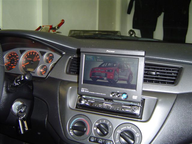

Sorry the whole thing isn't in the last picture, that was the only one I could find. Here is the new one (i can post with the foam in when I actually have time to get to it probably tomorrow).
