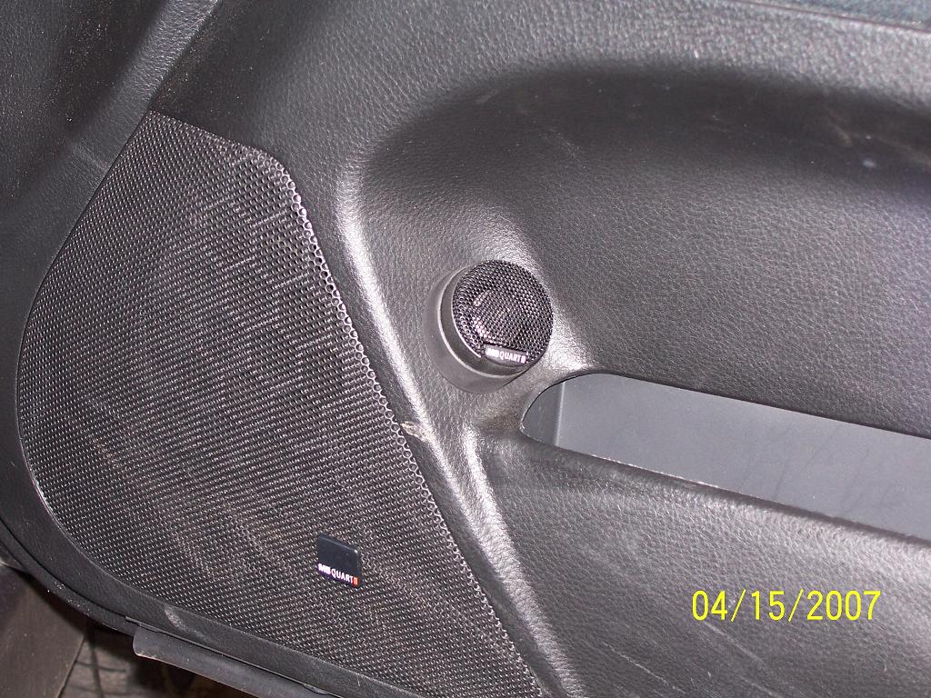

Fyi installed the MB quarts 6 3/4 without adapters. Used the stock 4 bolts to hold them into place and drilled 3 holes for the bolts that came with the speakers.
