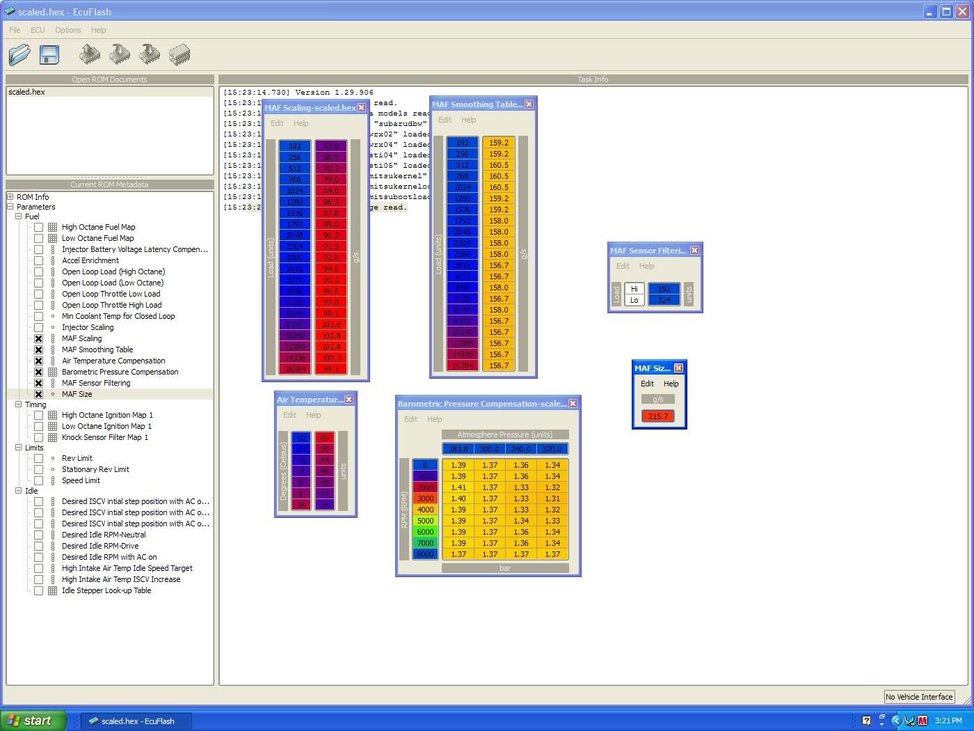

hey senate, does my stock scalings look right right to you from the photo? or rather, is the 81900016 def referencing the maf scaling numbers?
edit: nevermind senate, i had to think about what you said...

heres what mine looks like
http://i307.photobucket.com/albums/n...c/untitled.jpg

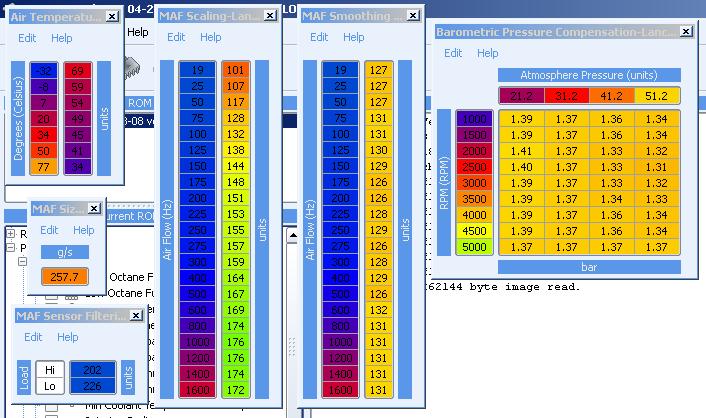

Here are my values with my 501 MAF setup...
