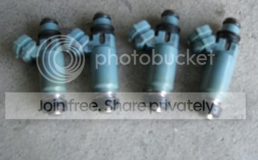

will 05 WRX injectors fit?
someone is selling them on NASIOC

sykou's Avatar
Posts: 1,078
From: Hawaii
get a pic of them... They are gonna be light blue in color. From the 2002-2005 WRX 2.0L engine
Old Dec 7, 2008 | 10:59 PM
  #120
4g94T's Avatar
Posts: 2,069
From: California
they're from an 05 WRX
