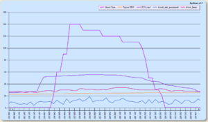

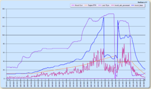

Yeah, that's what I was thinking...real knock = SPIKE, but...meh, I know nothing about this other than what I read.

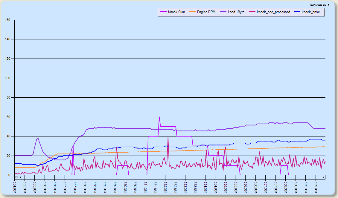

Anyhow, here's everything but a WOT log. There was a cop on my "go faster" road, and I didn't want to push it. The one spot here where I hit 150 load is in 2nd gear, but it's still somewhat valid I guess.
So, keep in mind here, 3 single, 5 triple, all mults are 18, knock load "thresholds" are all 10, and decay is 160ms. I have what I think is a bad TOB so that could (infact, I don't see any way it wouldn't) cause what I'm concerned about at low load cruise. I mean, if you idle with the clutch out (or in whatever it's called if I don't put my foot on the pedal), I can hear the rattle rattle and then when I push in it's gone....so at low load, it's probably noisier than it is at higher load.
Anyhow, I'll get a 3rd gear WOT pull sometime, maybe not tonight, as it gets dark so soon these days, and I might not be able see over there, lol. Lets see you guy's pics of adc vs base and what not, especially you Mitsu.Kid, I'm curious about that auto hybrid rom of yours. Also, the adc and base are only available in evo roms, right, since they are "MUT" addresses, so the base guys can't long that, right? I think ClixT was adding MUT to his base rom, but didn't, and went "evo rom" right? Anyhow, I'm thinking out loud now, and probably not providing anything useful at this point.
Attached Thumbnails Community Tephra Tweaking-50-load-knockstuff-tt.png   Community Tephra Tweaking-50-load-knockstuff-tt2.png   Community Tephra Tweaking-50-load-2krpm-knockstuff-tt3.png   Community Tephra Tweaking-60-load-3krpm-knockstuff-tt4.png   Community Tephra Tweaking-150-load-knockstuff-tt.png

Alright, expect some more fun stuff to get posted tomorrow morning. I've got logs from a stock lancer, and yes, you do get to log knock adc and knock base with a base lancer rom. My laptop battery basically just died on me like minutes before I got done reviewing the logs and my charger is at the office. Anyhow, results were basically knock in the lower rpms, knock in the upper rpms and knock all over the damn place....I forgot how much that dang stock lancer rom knocks.
So, knock adc on my engine is much much more jittery than the base lancers is...I'm thinking that is the TOB. I'll post some comparison pics tomorrow mornin'

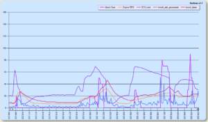

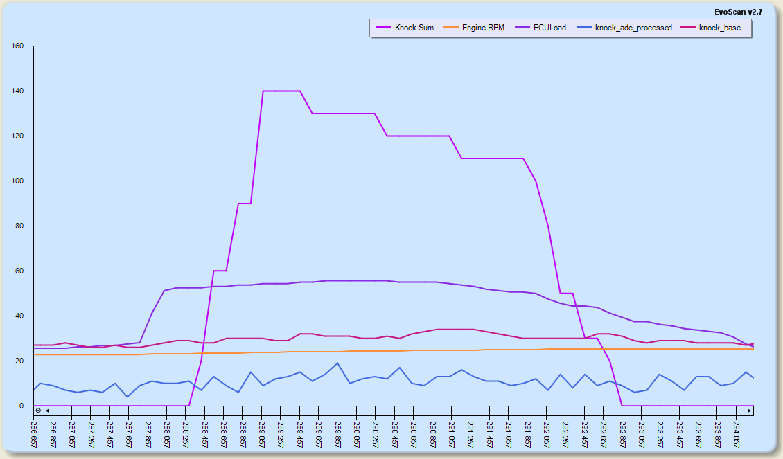

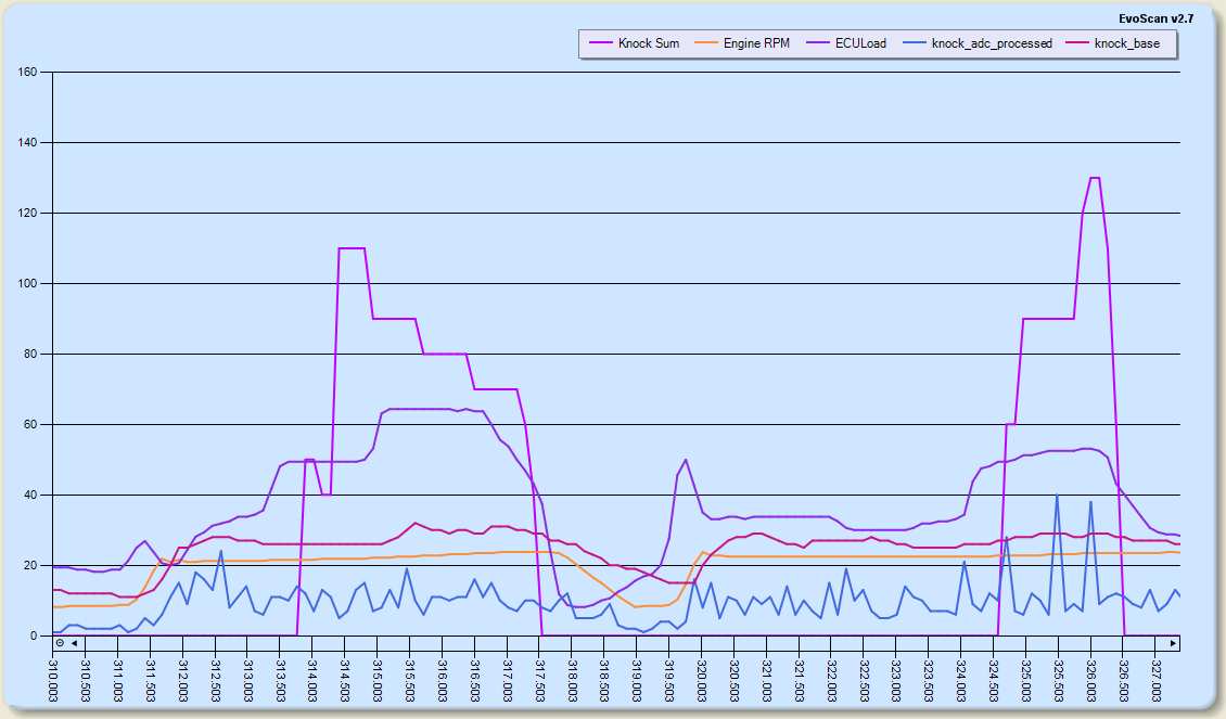

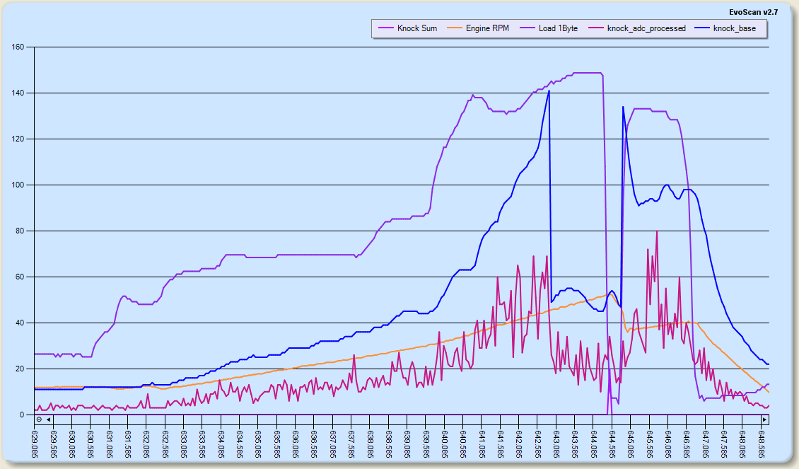

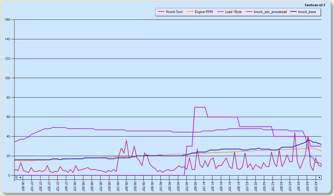

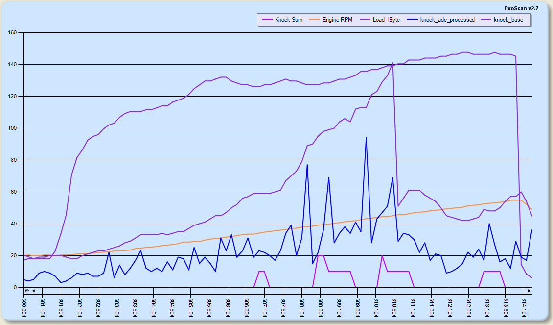

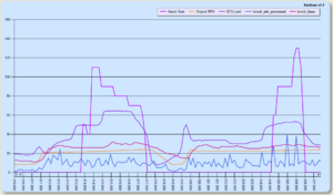

Here are the Knock graphs of a stock lancer, and I'll put my WOT pulls as well. I do need to pull timing, as those 1-2 counts are probably real. They weren't any counts, and I increased timing, and then those showed up...so I'm pulling timing to put it back where it was basically, and I'll continue sorting the knocks out and all that....but basically from comparing this to the stock stuff....we're not that far off. The 1 thing I am a little worried about is where the multiplier takes place on a stock lancer, whether it's 18 the whole way, or if it's 18 just above a certain spot. I'm guessing it's 18 the whole way, since the knock thresholds basically prevent it from registering knock down low. Our thresholds would be the equivalent to having the evo not register knock under 100 load...I think it's just not sensitive enough for boost (the base rom that is).
This post is all base lancer stuff, base lancer pics start with a 2 in the filename, easy for me to tell them apart that wa
Attached Thumbnails Community Tephra Tweaking-2-2gear-accel.png   Community Tephra Tweaking-2-14-knock-half-load.png   Community Tephra Tweaking-2-half-load-tons-knock.png   Community Tephra Tweaking-2-slow-accel2gears3krpm.png   Community Tephra Tweaking-2-slow-accel3gears2.png

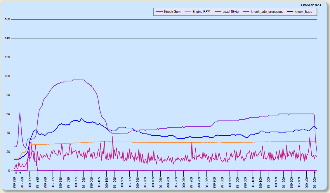

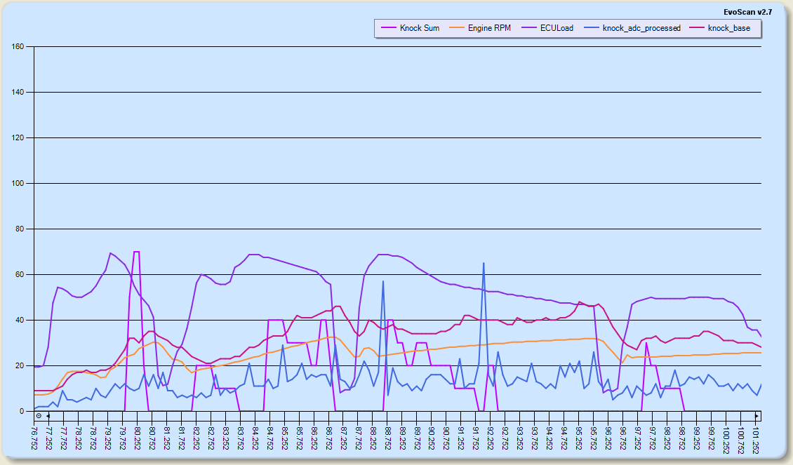

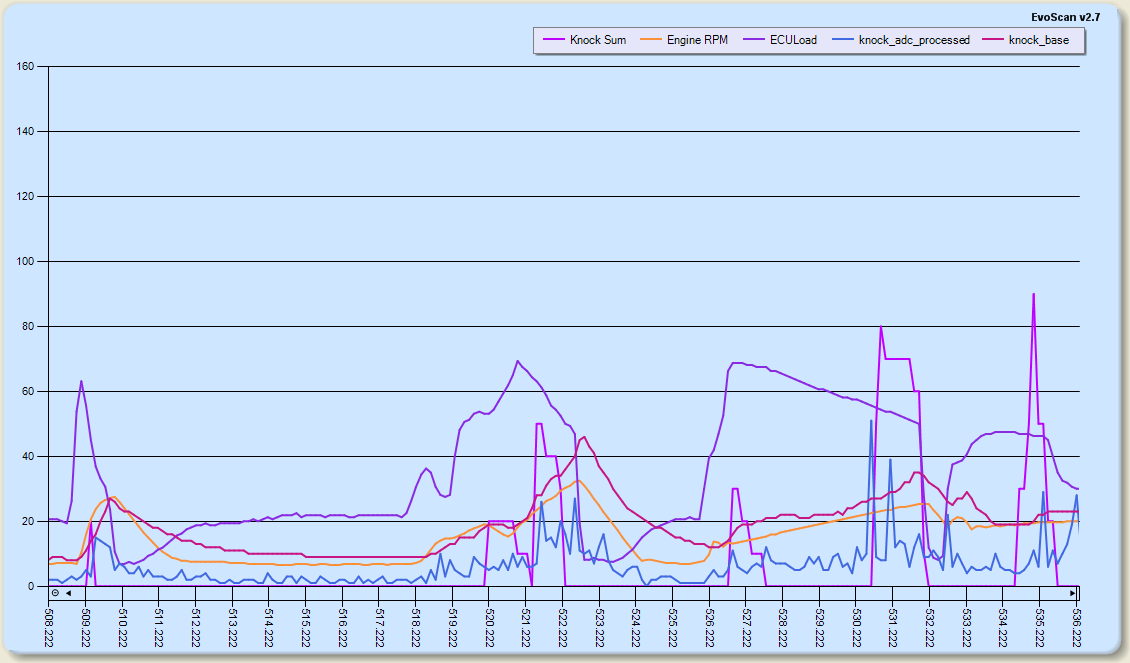

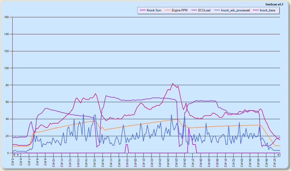

So, 1-filename is my evo rom, and 2-filename is the base lancer. The end of the "40 load cruise" is a very hard shift, where I am trying to create knock by slamming it into gear...only 2 counts though.
Attached Thumbnails Community Tephra Tweaking-1-40-load-cruise.png   Community Tephra Tweaking-1-wot-knockstuff.png   Community Tephra Tweaking-2-slow-accel3gears.png
How exactly do i interpret these graphs? breakdown for me plz?
