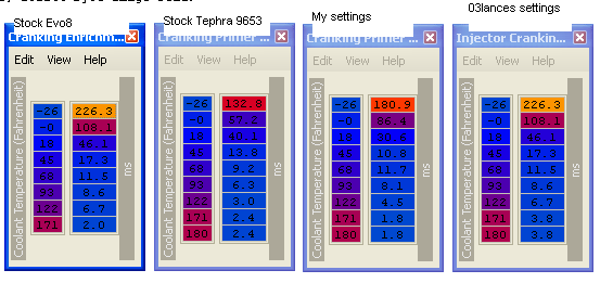

As for cold start, the tephra rom I have has significantly different values than the Stock Evo rom I have AND the scaling being used is "approx ms" instead of "ms", and if I convert between the 2, the results are no where near the same. I'm going to put stock evo settings in, and see how that does.
Attached is the ones I have to compare.
*Edit* scratch what I said....I'ma try what 03lances has, lol, since his is working for him
