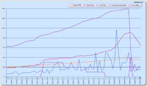

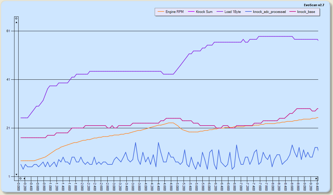

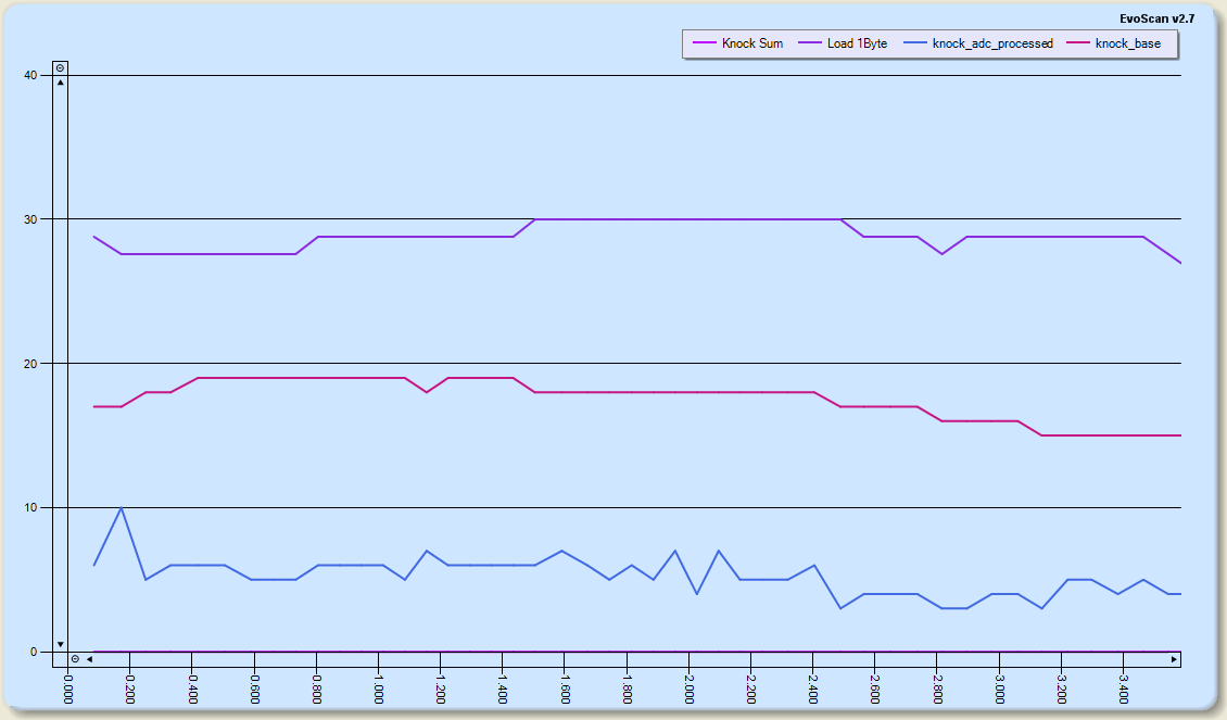

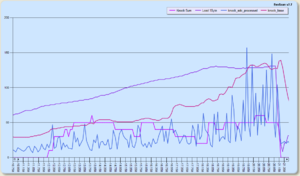

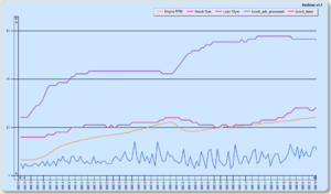

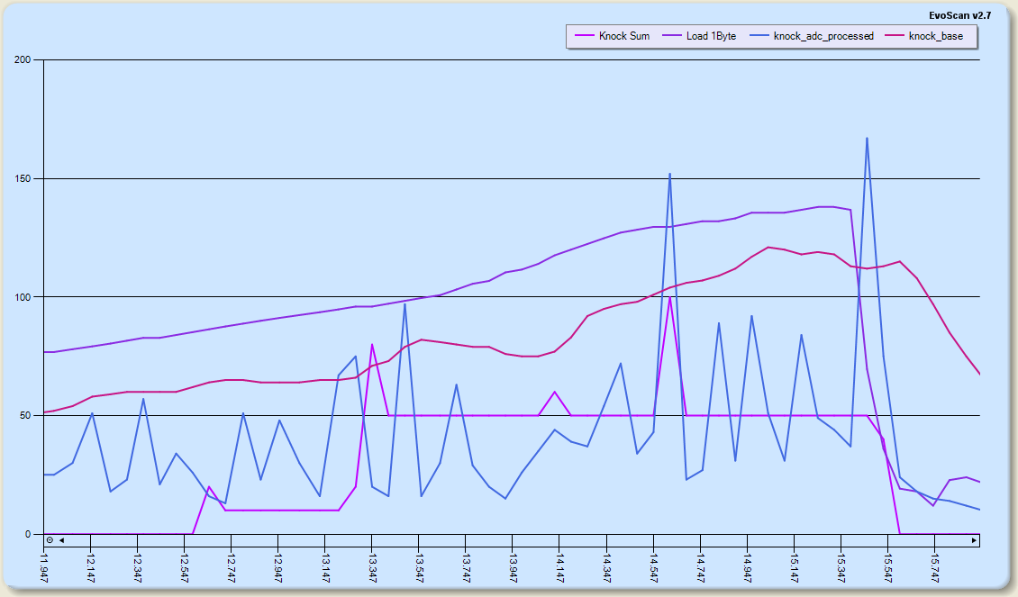

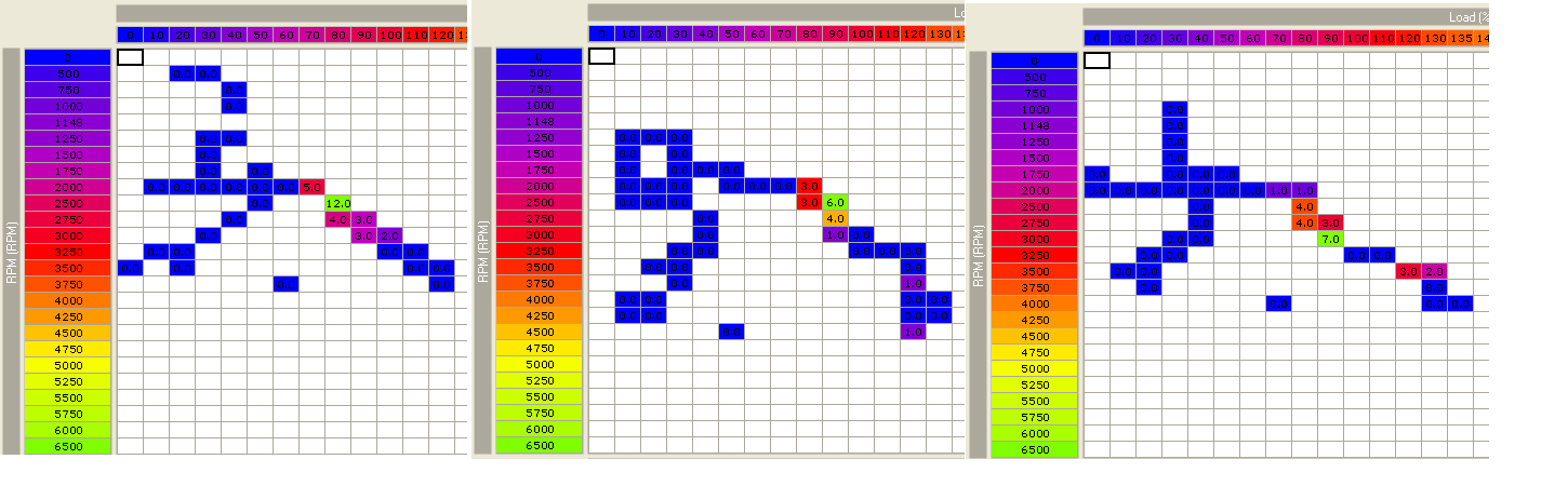

So, Mitsu.Kid's stuff is looking a little different. Let me know what you all think, but just judging from these 3 pulls, it looks like his car is either making a lot more noise than mine (even with the bad TOB) or he's got actual, honest to god knock. The thing to do mitsu, is everywhere you have those knock sums, pull 1 degree for each 3 count of knock, and do another pull. Lets see if the knock disappears or if it persists at the same rate, or what.
Notice how nice and quiet your car is accelerating at low load through the 2250 area, as opposed to my noisy *** car goin through there.

Also, you (Mitsu.Kid) are gradually pushing the pedal down, right? You're not just slamming it to the floor, I'm guessing, since the load gradually increases. Anyhow, you're adc is crazy compared to the base, which is why you see 10 counts, it's bumping the "knockbase" all over. Try less timing, I'm thinking, and see if those spikes dissapear. If they do, good, if they don't, pull more timing, and see then, if you pull double the amount you would expect you should have to, and the knock still doesn't go away....we can start thinking it could be the way the knock sensor is calibrated, and is too sensitive. The same settings may not apply between roms you know, so it's a guessing game.

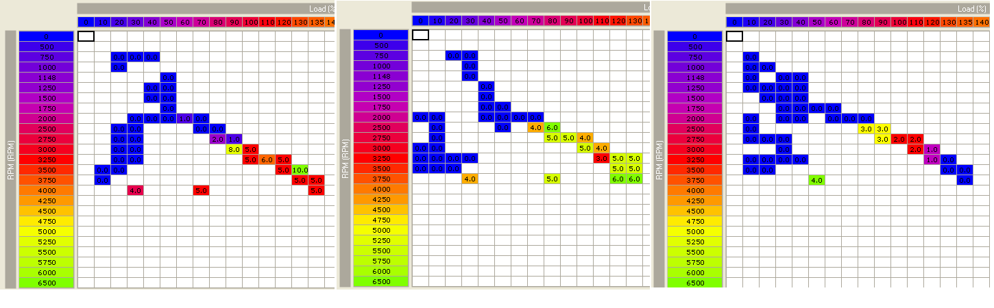

Hornstar, three more logs, this time i pulled timing 2 degrees from 100-130 load

Did you notice the way the knock past 100 basically disappeared? That means it was real knock...Keep pulling in the spots you have knock, like 80-100, I think.

Also, it looked almost as if the knock got slightly worse before 100 like maybe you have a big jump in your timing map. Make sure she's smooooth as a baby's butt.

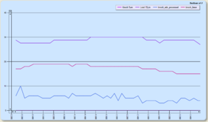

Hornstar, heres mine: i didnt do a WOT and its only a small run. i ran out of road..
no knock so far. i also turned off pretty much all of the tephra mods
and im using my "Custom" Tephra N/A map
Old Nov 25, 2010 | 05:10 PM

Looks good man, that gives me a little bit of good info, and it really gives Mitsu some info to work with. Basically, that ROM should read knock the exact same as the base lancers, so just believe that knock sensor if it says it's there on the auto lancer evo rom hybrid. Pull timing and iron it out Mitsu, and you ought to be fine. I think you may have done this, but I am not at my PC for thanksgiving, so I can't review them.
