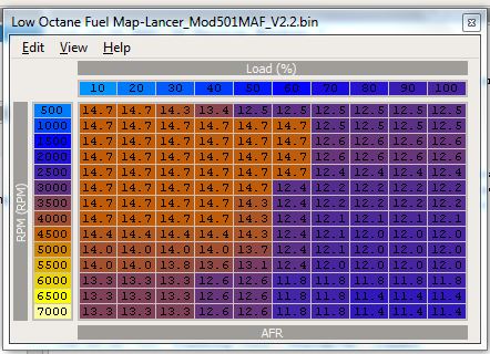

Old Aug 5, 2015 | 11:38 AM
  #40
dragunbayne's Avatar
Joined: Mar 2014
Posts: 65
From: US
Attached is a shot of my current fuel map. It does seem pulling fuel is bringing down knock consistently. Any timing I have pulled has been for part throttle knock. I have considered starting to use 93. I ran 93 in my modded and tuned GM 3400, but that made a lot more power than this. 93 should help me get the most out of this little motor for now though. I will add octane level to my logs now too.

yeah you can pretty much stop logging your ltft but I would leave injector duty cycle on. I'm not seeing the fuel map as well.

Here it is! lol

timing maps look fine, at high RPM you won't be running a lot of timing...i would work more on your fuel maps like jake is saying...although i think you could run a little more timing in the higher rpm, higher load area...(bottom right corner) ignition timing should be a smooth shallow curve, or at least a linear increase with RPM...jumping up and down the way it is, will cause flat spots in your power curve...but then you don't want a lot of timing at high load and low rpm, and you can have a little more with high rpm, and low load, but from top to bottom each column should be increasing, and you would end up with the gradient of color, as seen in this example...
keep in mind this one has the RPM on the x axis, so it increases from left to right...
