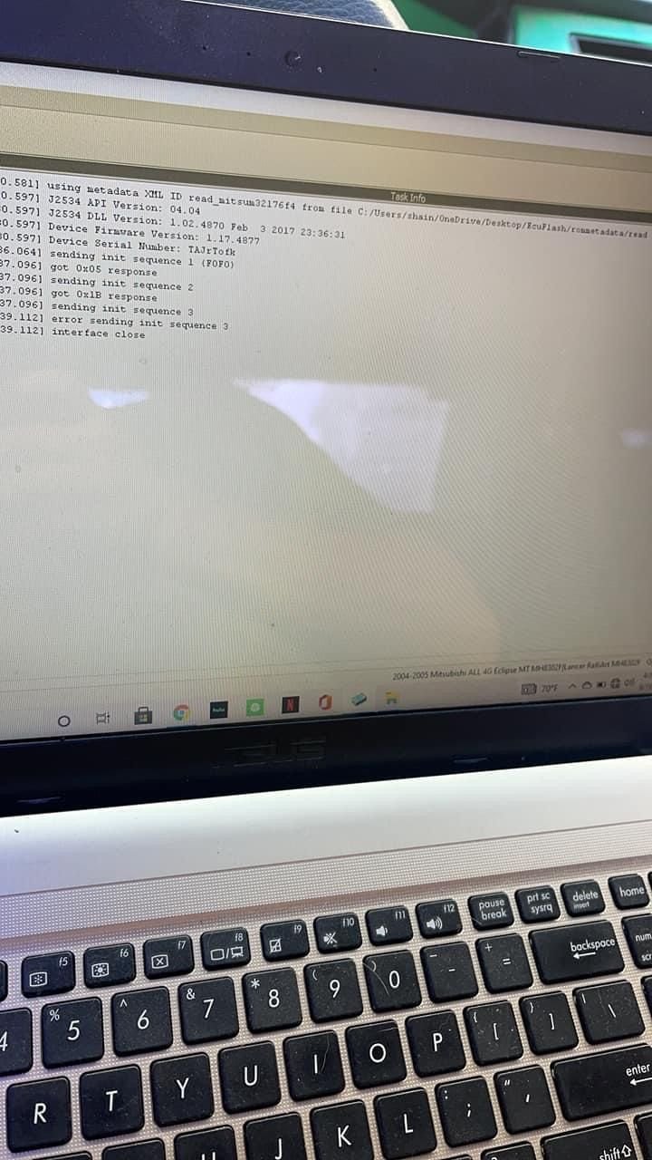

So I have a 2004 lancer es MT and can’t seem to get any reading from the ecu I’ve tried the evo8 read and it barely gave me anything. I’ve tried the 2004 oz MT and it says it can’t connect if anyone could help that would be amazing

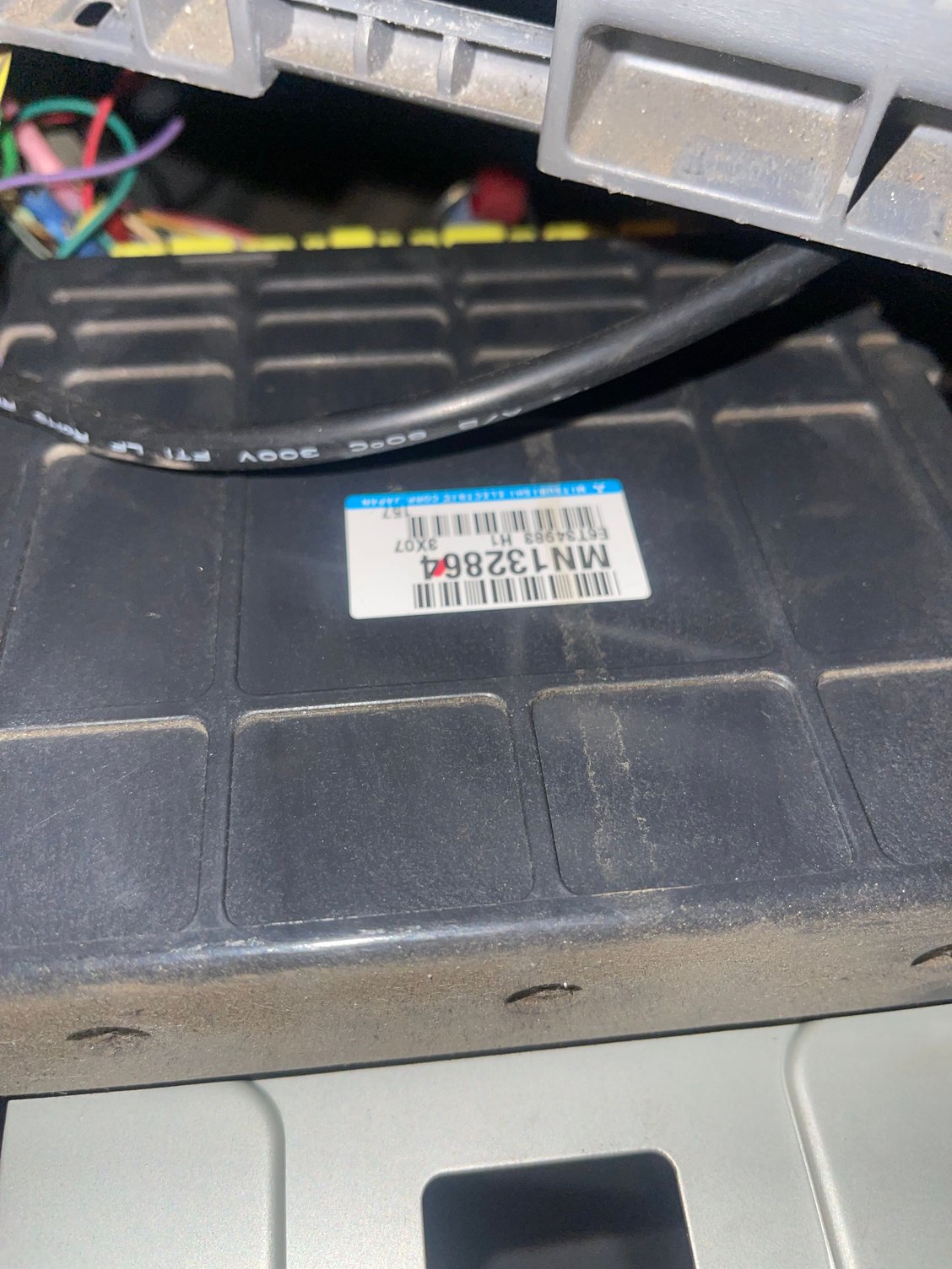

What model of ecu are you running currently? Better to post a picture of it. And make sure you connected flash pin to read the ECU file

I do have the flash pin plugged in and the front number is mn132846 do I need to open it up to get the other number from the inside?
Outside of ecu
Ecuflash readings after trying to get stock tune

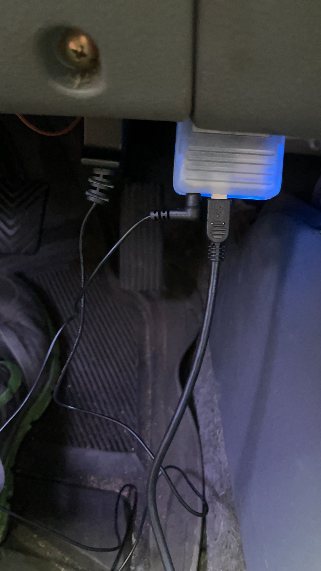

Reflash cable

Looks like the file location for the XML is wrong.
