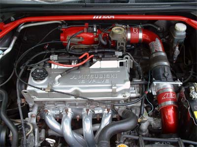

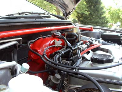

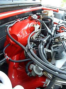

here's a few pics of mine...i hope they help...if you need more i'd be happy to take others from different angles and such..just let me know.
Attached Thumbnails RRM piggy back-im-side-evom.jpg   RRM piggy back-im-far-evom.jpg   RRM piggy back-engine-bay-2-evom.jpg   RRM piggy back-pb-ecu-evom.jpg

hypo, the T-connection on your vacuum line is looking a little ****-eyed. if you switch it around it might look a little cleaner/neater.
