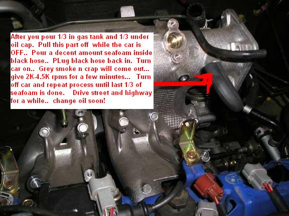

Originally Posted by Kid Lancer 7
For the people that are unsure .... this is where you pour the seafoam down the vaccum hose.
Quick question, in the picture the sensor is disconnected, is that necessary or recommended or something?
