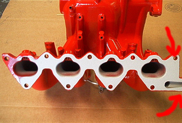

Ok so after check all of the lines numerous times over the past few days I figured it couldn't be them. Lastnight around 11:30 I thought it could've been something with the piggyback so I figured what the hell and took that off. The car ran even worse with it off. So today I went out there and just took it all off, TB+IM+ and all the other junk. When I got down to taking the bolts and nuts off that attach the manifold to the head I found that there were 2 that somehow didn't have bolts in them at all and after looking at the gasket I could see that there was something leaking into the closest port. It was the 2 that I drew arrows to on the attached picture. The one was hidden by the TB bracket so thats probably how I missed it.
I feel a bit stupid for not noticing that we didn't put those in but I did have 2 mechanics working with me so I think they should feel even worse. I still need to get the piggyback in there and then I'm going to go have some fun and see how it goes.
