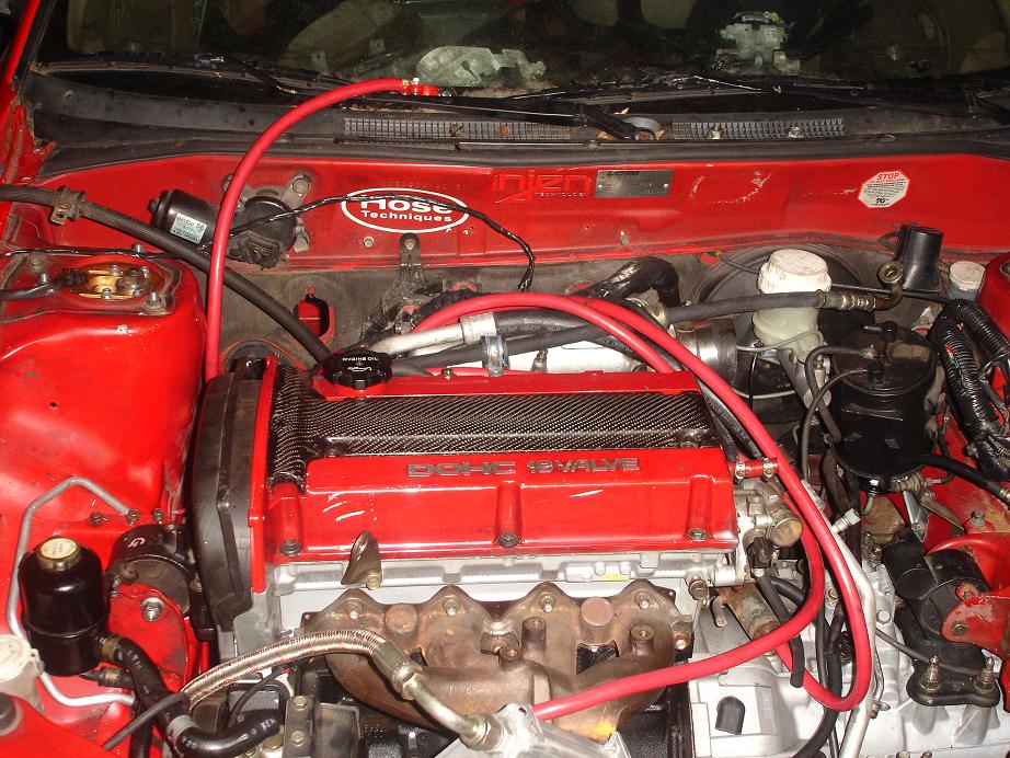

Originally Posted by Shingen
I didn't realize that miragers were already done the swap. KillaB how did everything line up, was there major modification needed to be done?
I didnt do it personally.... from the guy on the Mirage board, he claims he did it in a 3 day weekend (entirely possible if you have all the parts) and there are minor tihngs that you have to upgrade / cannot use (like passenger mount, fuel pump, struts / springs e tc). He used the 6A13TT.
THe other guy who did it whose car I posted, Danny, he (obviously not stateside) had the 6A10 in his car originally, so dropping the 6A12 MIVEC was much easier since he could reuse most of the parts (mounts etc).
Of course with both swaps, you have to be friendly with wiring. Everything fits, per se, and lined up well. Looks like a tight fit on both of the cars but hey a tight fit is a fit.
This is the Mirager who swapped the TT in his car.
And the reason why I think swaps are not as daunting as people make them out to be is because I am knee deep in one myself. It has not been "hard" per se, but my priorities right now are school then work then car so I hardly have time to work on it. But this is my little project here.

KillahB... are you doing the FWD setup or are you going all the way with AWD? Good job nonetheless...
Old Aug 10, 2007 | 11:41 PM
  #37
KillahB's Avatar
Joined: Jan 2003
Posts: 1,011
From: Orlando FL
FWD for now ... .too poor (and too much customization) for the AWD setup ...
