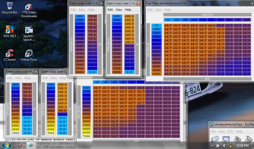

Yes, I knew I wasn't going crazy when I felt like I wasn't getting enough fuel at higher RPMs!
Top right is the AUDM Maps for the DOHC 4G93. Bottom left is my tune

Hmm... That is interesting. But the thing is you can't go off of those numbers of 11.0 and 12.4 thats on the map. That number is what the ecu is told to shoot for. There are many things that factor in that, Maf scaling is important, injector latency, and other things. Those overseas numbers may equal your numbers, but just in a different way. The only way to know is your WB. That is what's giving you your real reading, not just a double check.
But on the other hand maybe you're not getting enough fuel. If I were you I'd switch to big maps, give it more definition, and just go ham on that rom! Lol
But!... I wonder if your stock rom has the fuel and load cap...

At least it's something to warrant a little more investigating. I just discovered Roadspike's ROM and regret not loading it from the get go. I'm gonna try and transfer my current map onto it (Like I said, not exactly a tuner). If anything, I can load up my current .hex/xml file an the AUDM .hex/xml if anyone would like to take a gander.
**Edit**
So I had a shop who specializes on Mirages and did the swap take a look at my ROM. He told me that there were indeed issues with my Maps. I'm gonna have him email tune and see what can be done

I was poking around a Mirage forum and ran into David at DSTuning, who specializes on tuning 4G9X motors. I sent him my ROM and he told me it was out of whack. He's gonna e-mail tune my ROM since I already have ECUFlash, EVOScan, and a Tactrix cable. But here's the ROMs for my car and the AUDM DOHC motor along with their corresponding XML.

I just got done logging data for the version 2.0 ROM that David at DSTuning did for me... Wow. No offense to my previous Tuner. He's a wizard when it comes to the 4G63 and It was kinda my bad to have him tune my 4G94 ROM with no reference to the 4G93E maps... but the difference is as clear as night and day. I can't wait to hit the Dyno again!
