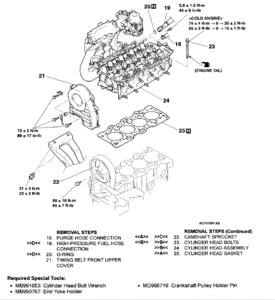

I can get any picture like the ones below for any car up to 2004 so if you guys need anything please post here the year of the car the make, model and engine!

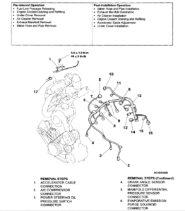

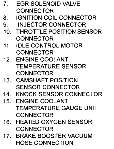

this here is a 2002 Lancer OZ head gasket replacment...
Attached Thumbnails Cylinder Head Gasket-98649662.gif   Cylinder Head Gasket-98649663.gif   Cylinder Head Gasket-98649664.gif

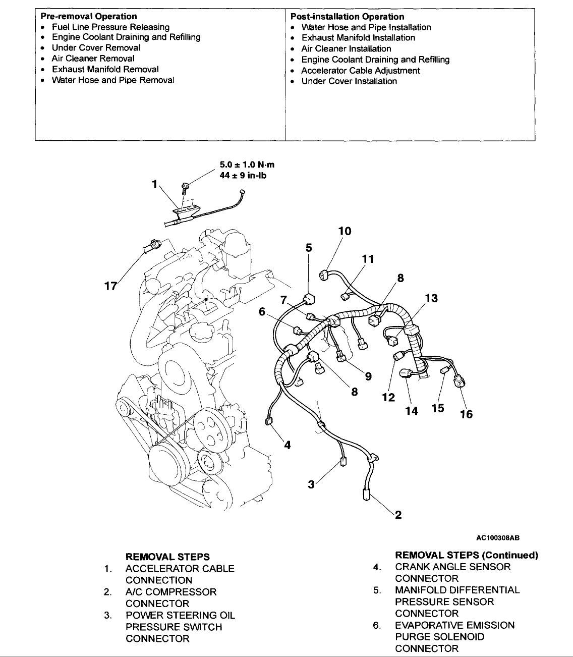

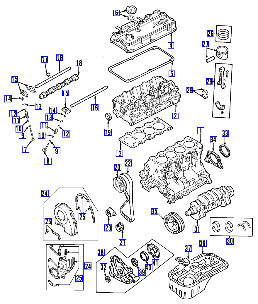

all engine

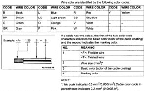

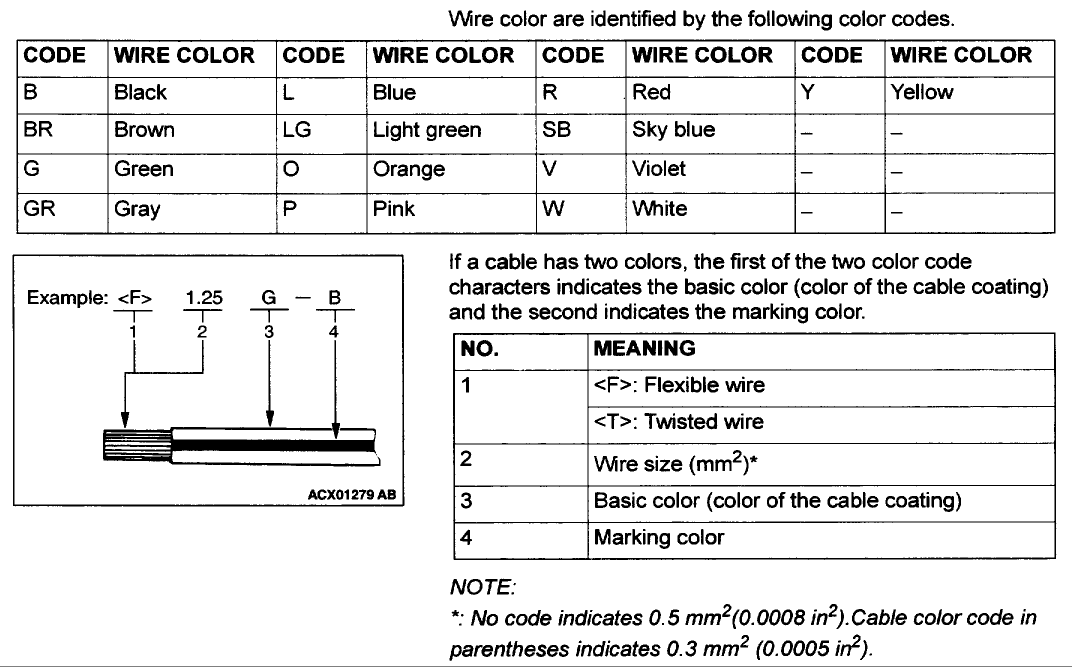

wire color codes

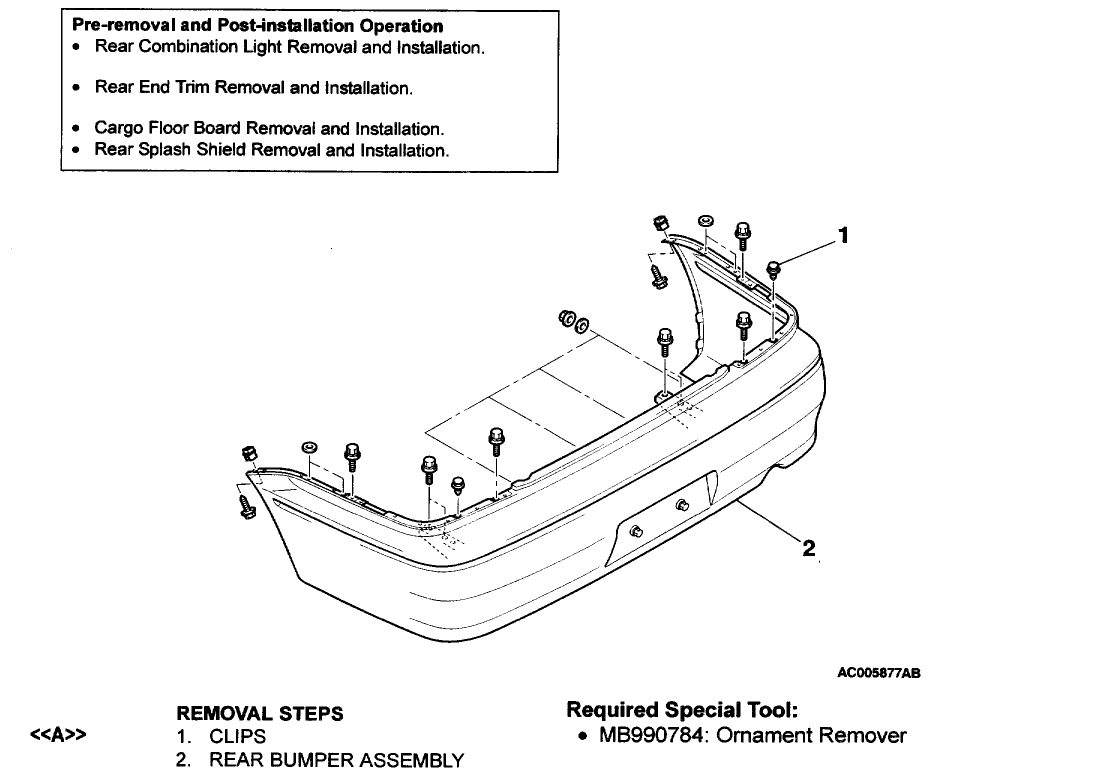

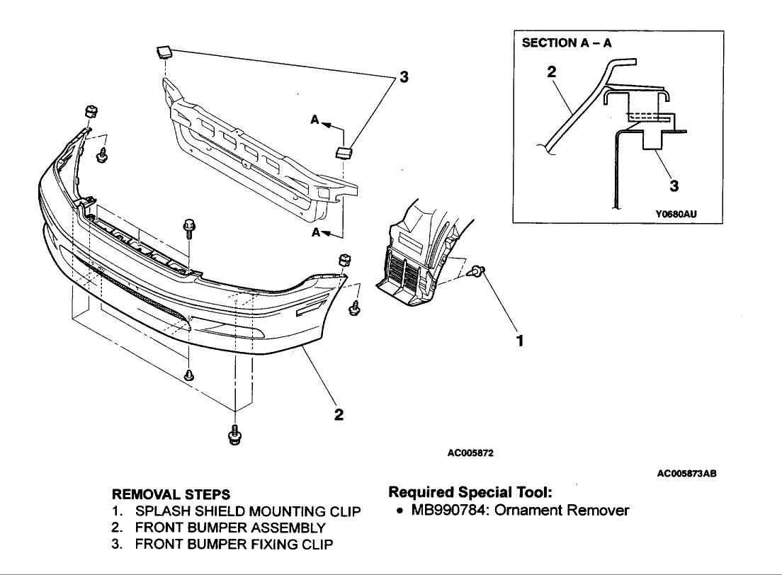

bumpers /front & rear/
Attached Thumbnails Cylinder Head Gasket-97439230.gif   Cylinder Head Gasket-97439243.gif

Um, one very important thing that your cylinder head gasket thing is missing is the tightening procedure. It's at least 5-6 steps, and it's very important. Unless they changed the manual, that's not the whole procedure.

I guess this is the main problem with mine. The tightening procedure for the head gasket. I was afraid that over tight can make more problems with it.
