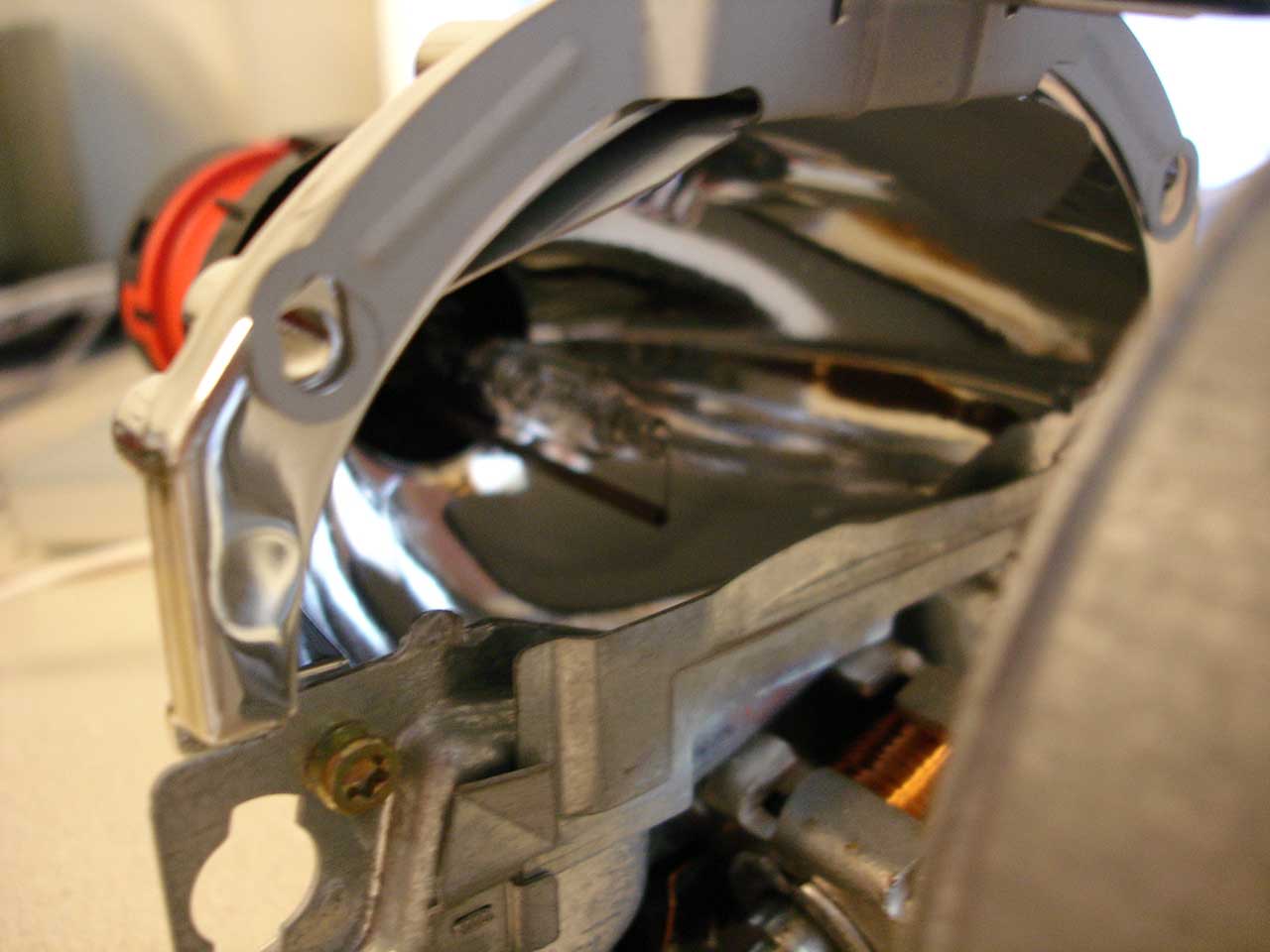

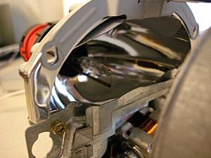

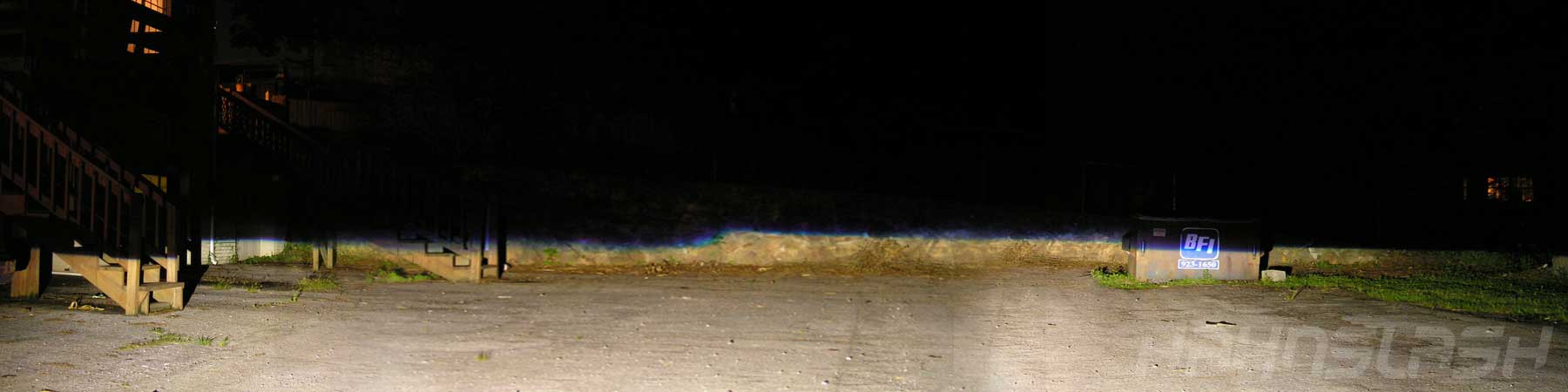

haha, well, one of the good things about getting projectors, is with a simple mods, such as adding a few washers or slightly bending the shield on the inside, you can give your self bright white projection light with but the cut off will be colorful, this is what you want because it is not as easy to get pulled over by cops for having illegal color lights. Just look at these attached pics with a nice colorful cut off. This is what causes that beautiful flicker from the headlights when the car goes over bumps in the road such as the blues, purples, and whites. This is what you should be aiming for.
because of this, I think it is just plain stupid to sacrafice the light quality just so all of your light can be colorful, which i sharder on your eyes and will make it easier for cops to spot you out. but to each his own, I am just sharing all that I have learned so far.
-Justin

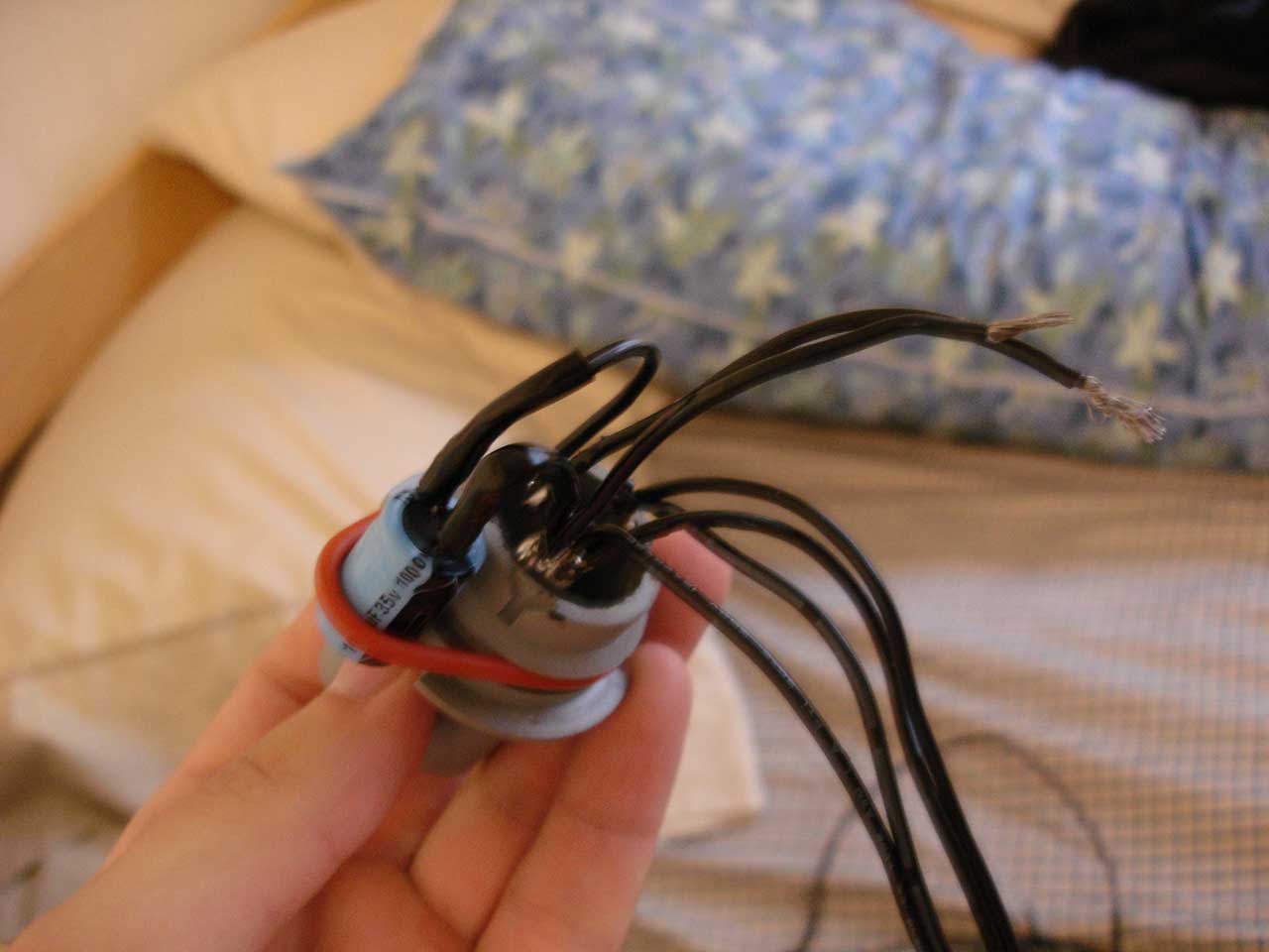

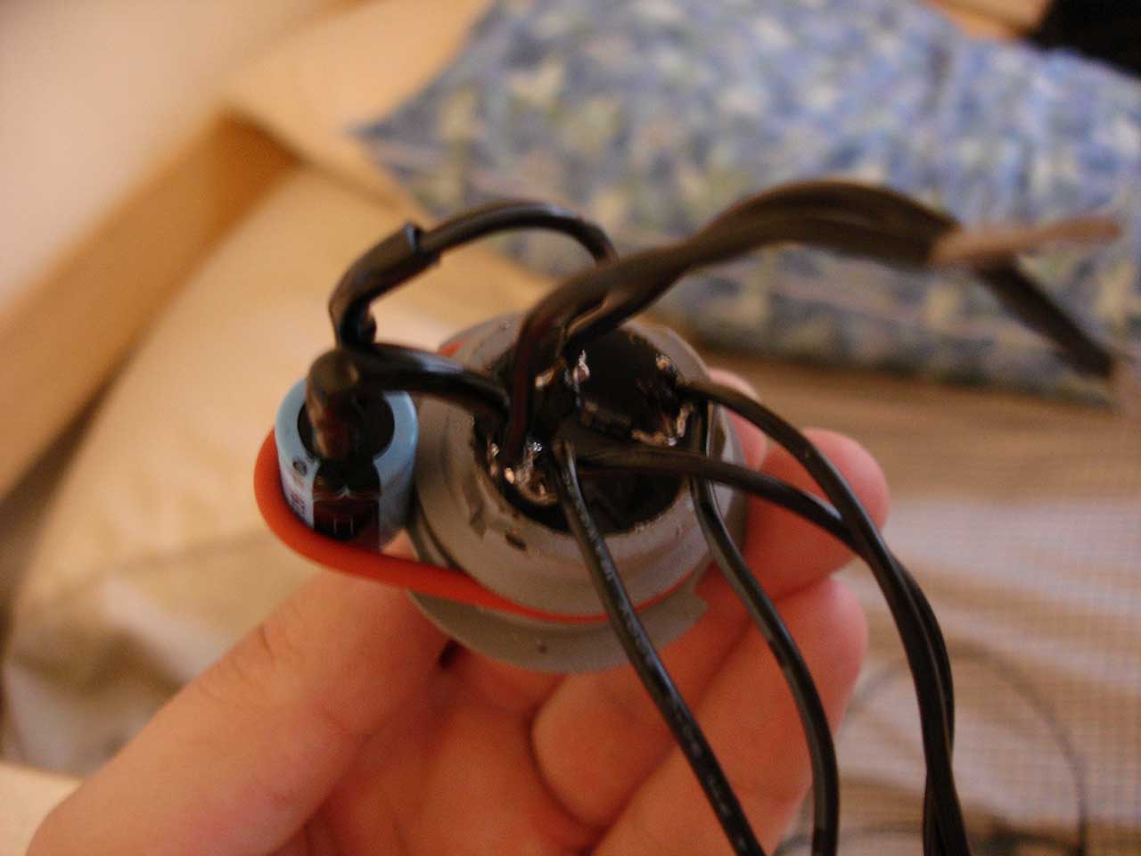

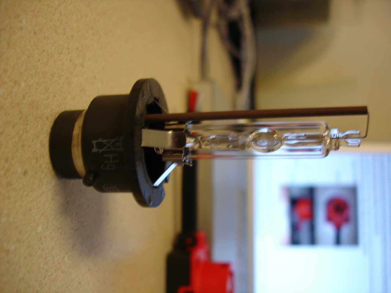

ok, finally got my D2S bubls in with there wiring harness adapters, so now I need to adapt them so they fit my current harness's. I also finished the harness for the 9007 adapter so that I can use my hi beam without shutting off the low beam and also so that there is not a power delay when I switch from Hi to low which would cause the lights to flicker, this is not good for HID's haha. so here are some more updated pictures for everyone. if you want me to explain how I made my harness's just ask and I will make up some wiring diagrams.
-Justin

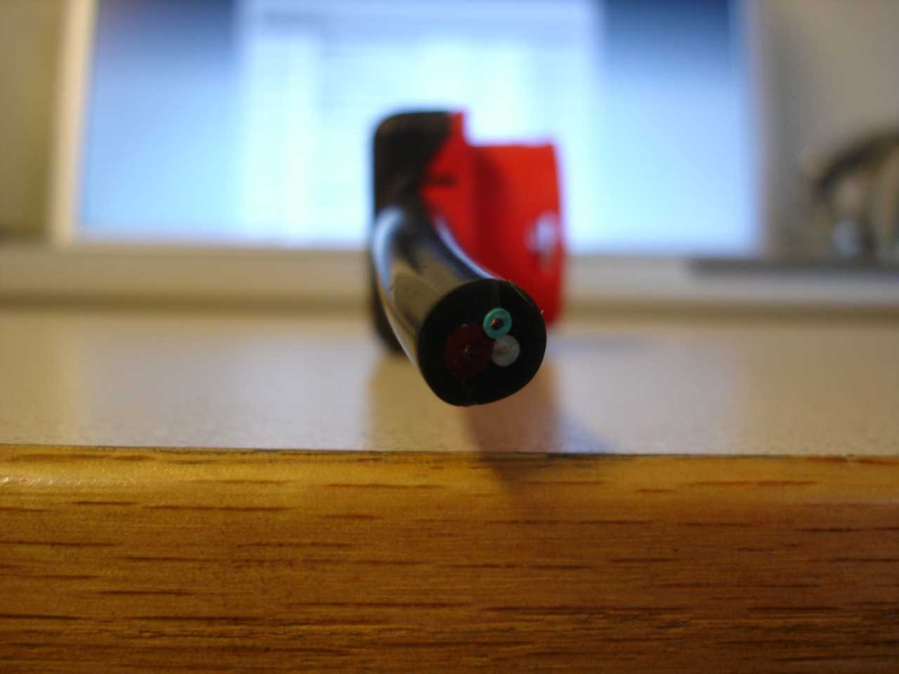

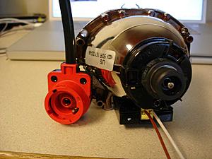

Just as a reference so the info is available on these boards. if you do get real projectors from a production car such as an Audi, BMW, Mercedes, etc, they will most likely use D2S bubls. These bulbs have a special wiring harness and it looks like it has 3 wires inside of it. There are actually only 2, the third white wire is a kevlar strand to help keep the wire from being stretched. I would also like to note that if you are going to make your own adapters for these, use automotive silicone to seal all connections and keep all High Voltage lines at the very least 5mm away from one another to prevent arcing and potential car fires. If you have any more questions please ask me.
-Justin

ok, well I decided to just post the wiring diagram right now haha. ok. for a 9007 adapter I just broke a light bulb and soddered everything I need to the appropriate spots. If you are looking at the bulb where you plug it in, with the notch up, it is low --- ground --- high. I will try and put together a good looking diagram in a bit, this is what I used when I was designing and testing my current hids to make sure that the lights stayed on at all times and still allowed me to use hi beams. the diodes are there to keep the current flowing to the low beams at all times and also to prevent EMF spike back when the HID's are shut off which can potentially burn up your stock harness. the capacitor which can be seen between the ground and low beam was to fix an occasional problem that I saw. Every once and a while the lights would flicker if I was constantly flicking the hi beams. This was caused by a brief lack of power on both the hi and low beam wires. to fix this, I placed a capacitor on the low beams going to the relay. what this does is acts as a battery for the few miliseconds that there is not power, which keeps the relay open so the ballasts keep a steady flow of power at all times. This will give your ballasts and yhour lights a long life and hopefully keep you from blowing anything up haha. as always, if you have any questions feel free to ask.
-Justin
PS this design will work for both single and bi-xenon projectors, just remove everything after the red lines and you will have no problems.
