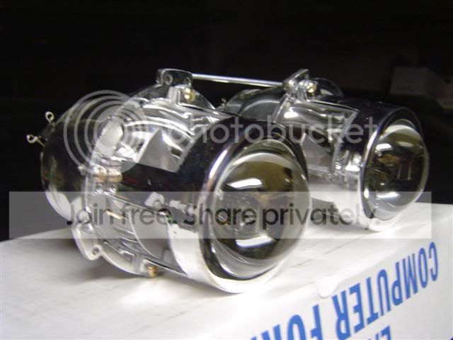

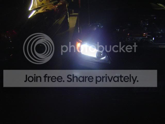

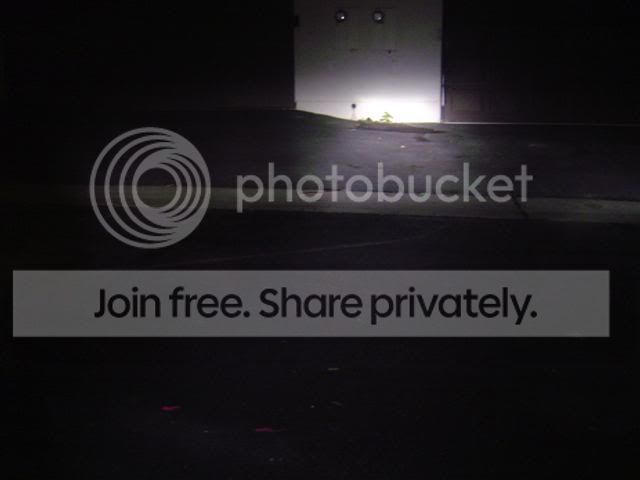

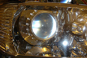

well, im pretty much doing the same thing but with my cedia lights, should be done this weekend(hopefully) or i am assed out, what are you gonna be using as a shroud? damn you headlights have a crazy glare, cedia lights do not have a glare like that, i dont think that HID's in stock chrome housings are safe....yikes
not to hijack your thread
thats what this is gonna be about, ill wil be doing a step by step for retrofitting with my cedia's, process will prolly take awhile but posting on here would make me want to finish the project faster, ill will update as it goes, feel free to ask quesitons if need be, i may end up buying an extra pair of cedia headlights, to get this done, so ill start tonight by posting things needed and things i am going to use :wtg:

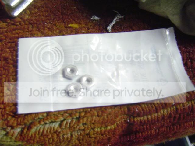

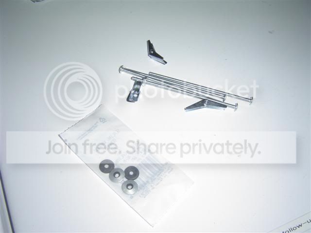

things bought so far:
H1 projectors
screws and nuts

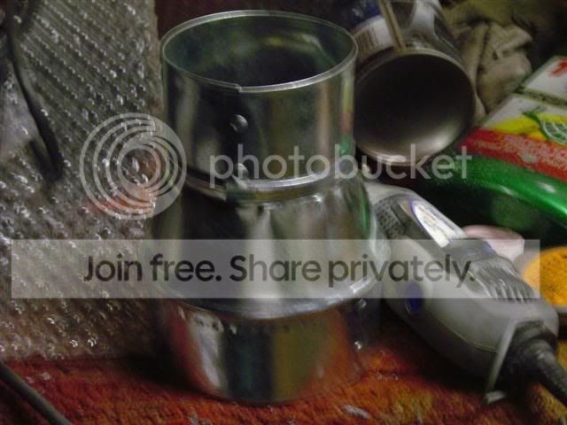

metal ducting

some pics to start ya'll off with...
pics of projector and lightbeam
pics of regular HID kit and light beam

note: i wont be using the metal ducting anymore, ill be using PCP which fit better, log on to SCLC.net if you guys want updates, (search for projector retro)
nvm, heres the link http://sclc.net/sclc/forums/viewtopic.php?t=1356

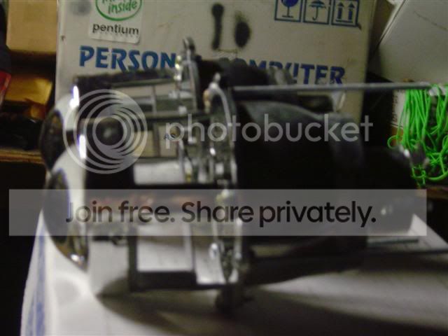

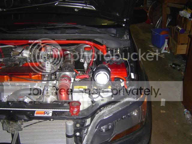

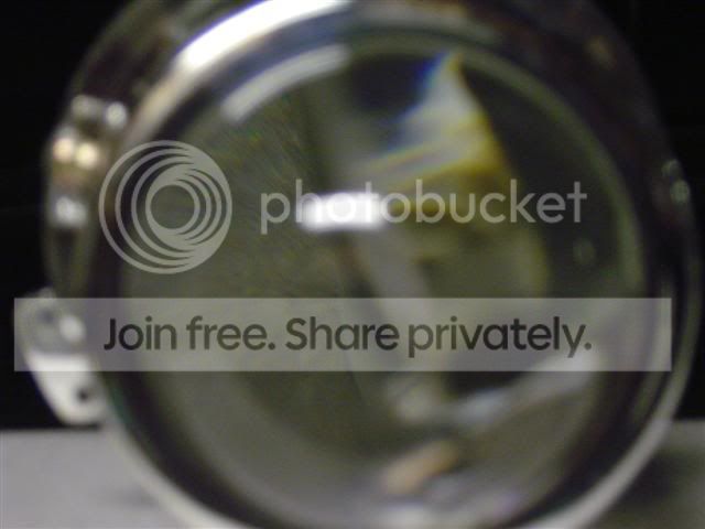

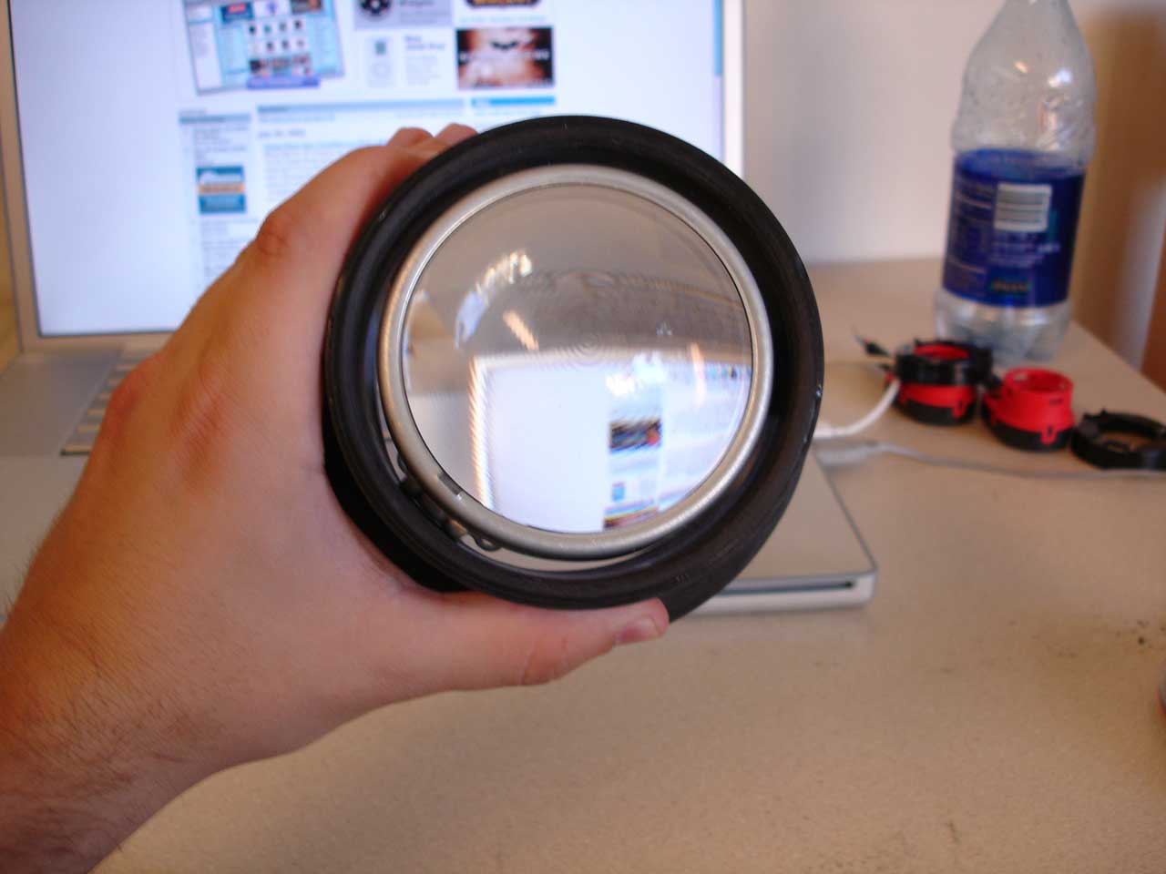

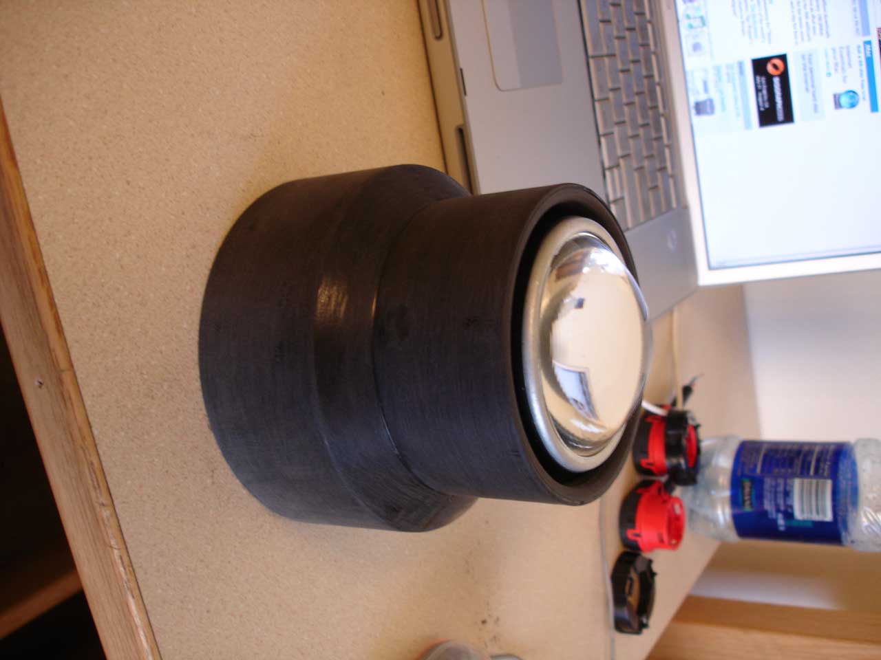

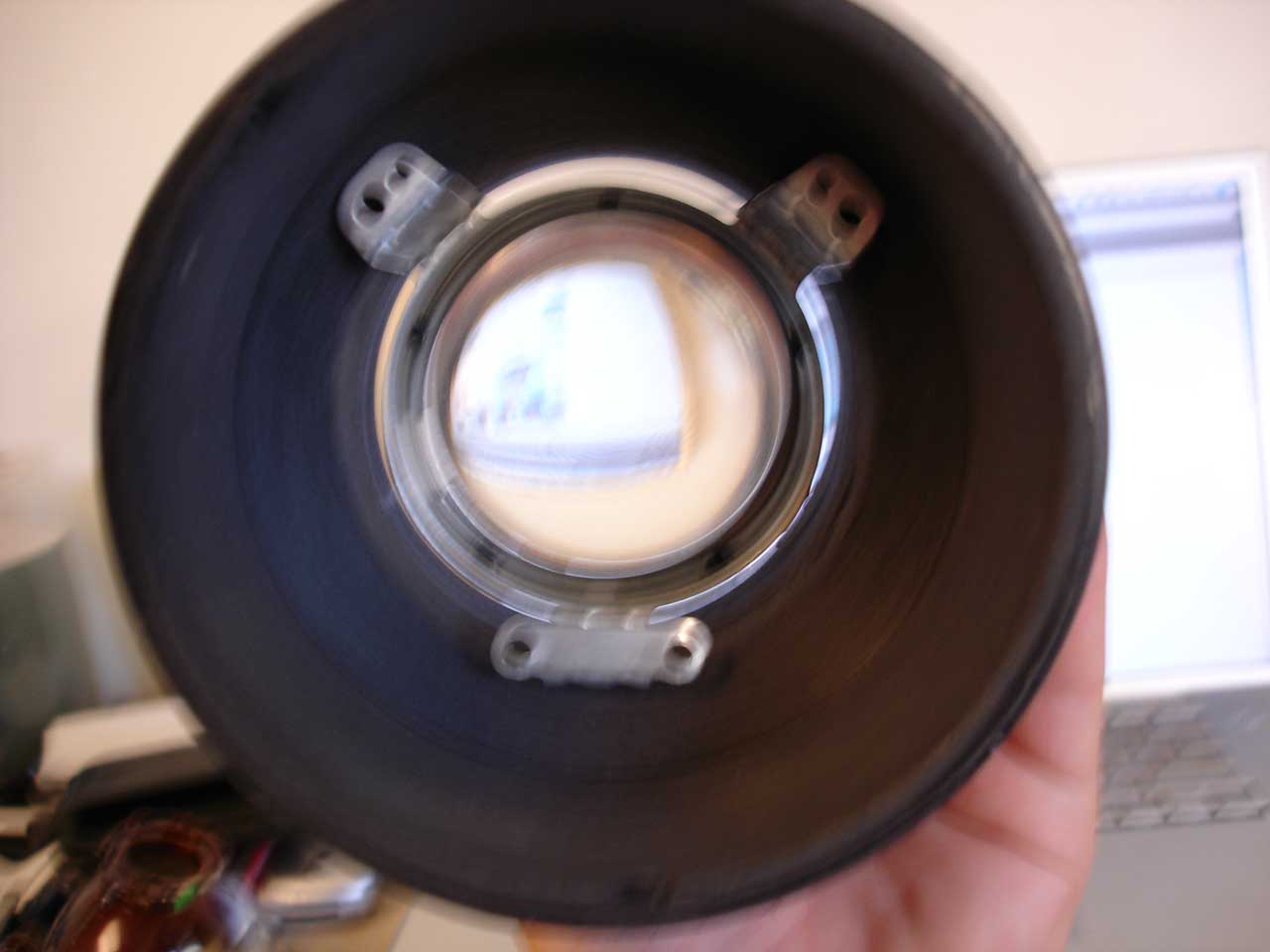

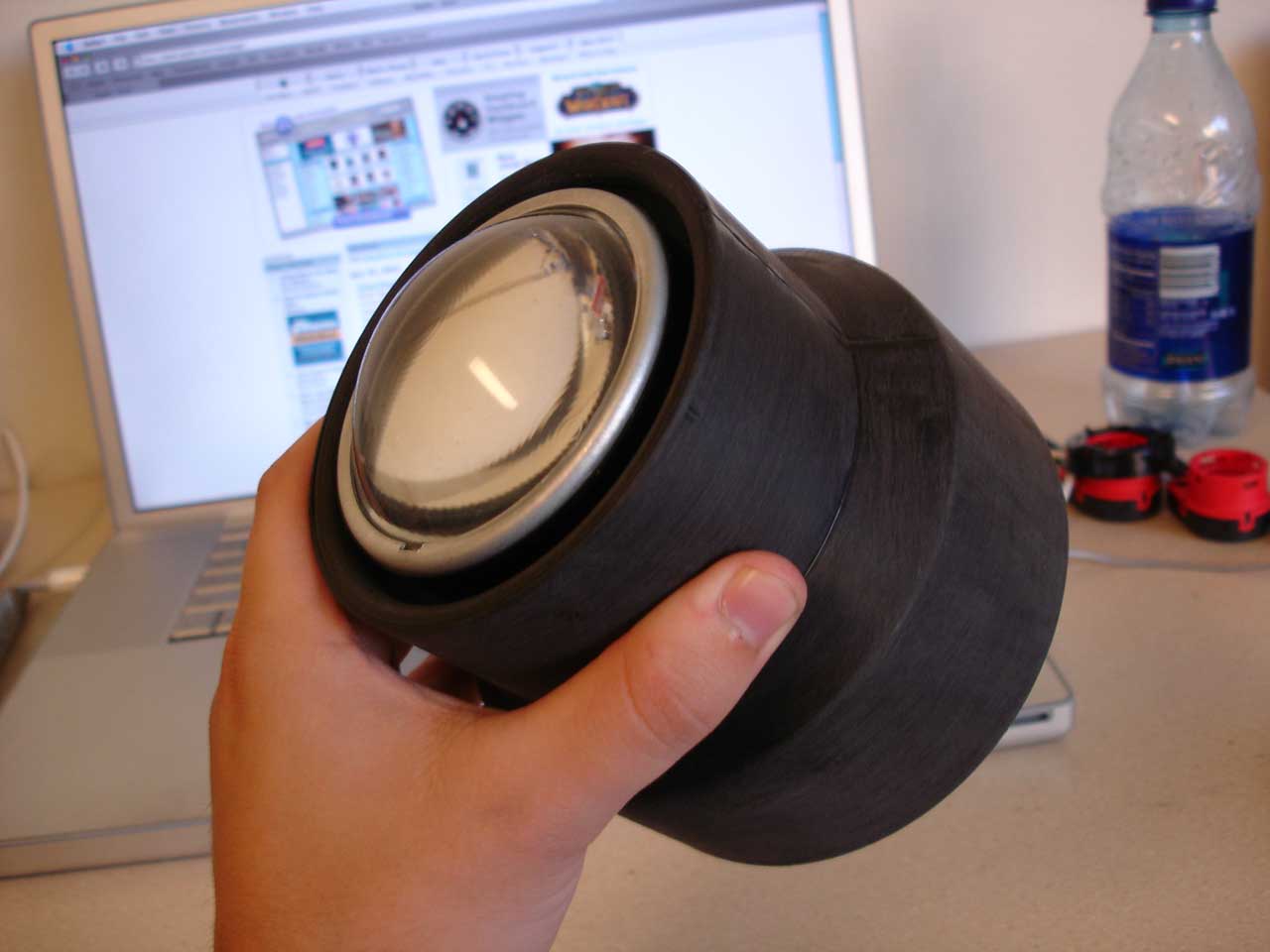

Update!!!
ok, decided to just do the retro myself. I finally found a nice piece of ABS that would work well for a shroud and when a small piece of 3" PVC is inserted it covers all the gaps left by the ABS. granted it required quite a bit of sanding and dremeling to get the projector to fit properly, but it does now fit and with a little more work, the reflector bowl will fit too. I will also be cutting out the stock reflector tomorrow so that this will fit and I will actually be able to aim my lights using the stock adjustments. I also decided after looking at many other cars with projectors that I would get rid of the stock chrome look and adapt a color match to the car (silver) which is already looking 10 times better than stock and does not look as bad as the blacked out stuff does on my color car. ill post some more pics tomorrow afternoon. Should be interesting to see the final product. for you guys who need an idea how big tis pipe is, it is exactly the same size as the stock turn signal housing (which I am convertiong to driving lights) so it should look really nice being so symetrical.
***Note: The picture of the projector was before I did some custome dremeling to the shroud so you might notice that the projecotr itself seems a bit recessed, that is because it is about 2 in back haha. but that gives a general idea of what my final product will look like.
-Jusitn

DAMN the projector IS HUGE!!!! looks good tho,
my only thing is that the pvc you are using might be to thin...may have a cahnce of melting , i used the thickest PVC i could find....looks great so far
while your lights are already open might aswell black out the side of them as well

yeah, this projector is 3" haha. nice and big and will be seen from far away. the ABS is still more than a 1/4 of an in thick. plus it will be lined with aluminum as a reflector shield. from what i've read, the ABS and PVC may get a little bendy under high temps but thats not until 200+ degrees or soo and at that point the light will be likely to fall apart on its own haha. I will also be using custom vents like the stock hosuings do so that I can get a bit of air flow but keep the moisture out. cannot wait to get these done, been seeing you guys making some good progress and now its making me want to finish sooner.

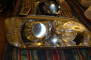

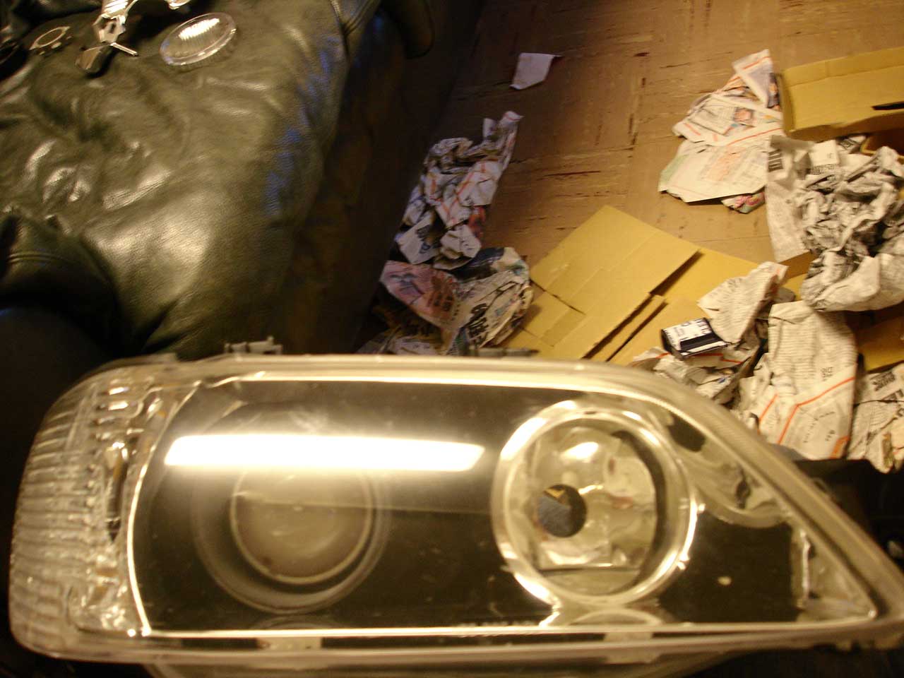

here are some teasers for you guys, almost done just need to have the backing to the shrouds to be finished. That picture is an actual cut off from the housing, with the light put back together. =)

Nice Powerbook. =)
Old Aug 24, 2005 | 01:28 PM
  #42
alexis525's Avatar
Posts: 397
From: West Chicago, Illinois
wow that looks so much better than stock... if we could only get a company to make projector lights... anyways it's looking great! more power to you
