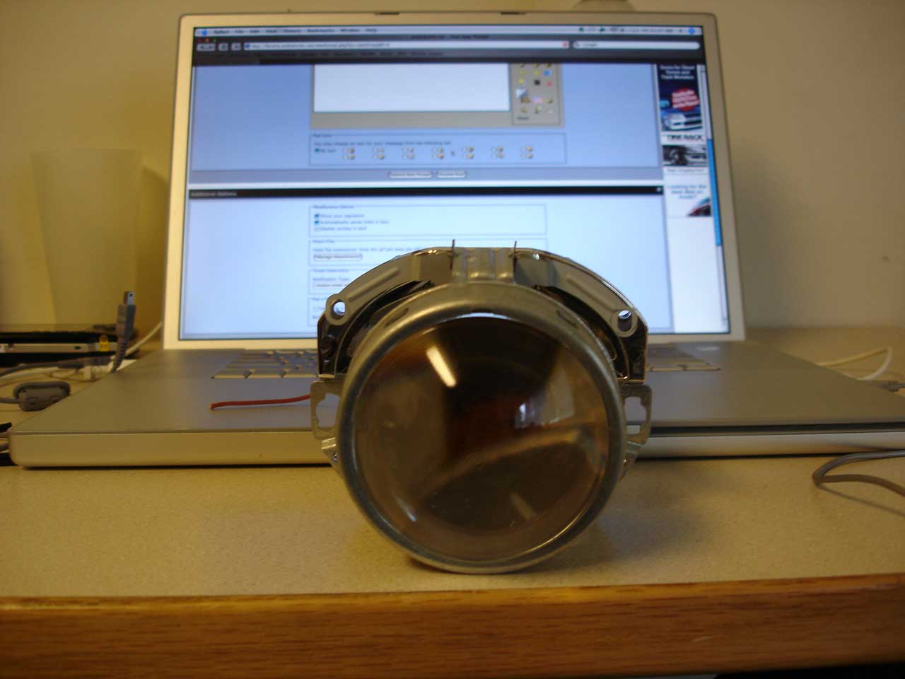

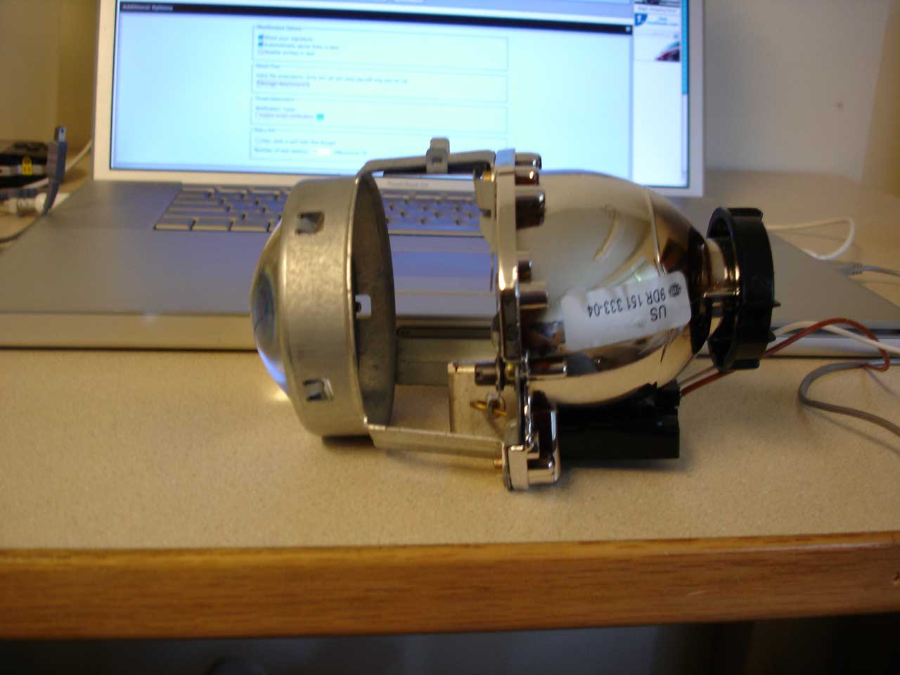

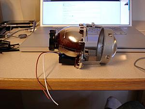

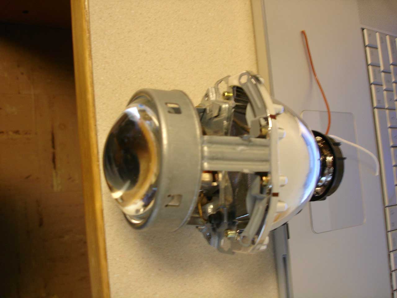

Don't know if I will be the first or what, but I will be having Audi RS6 Projectors installed in a pair of OEM head lamps by hidretrofit in about a week or so, it will take a week for him to fit them, and then I will get them back. got tired of driving with hids and not being able to use them to their full potential. These projectors are Bi-Xenon so I can still have high beams. I will post some more pics once I get the housings back, and once I install them.

nice, there is someone else trying this with civic projectors i think. Good luck post pics when done. btw if you dont mind what is the pricetag on this little project.

so far, 160 shipped for a new pair of OEM headlight housings, 202.50 shipped for the projectors, and then $350 for the projector retrofit. I already have a D2S compatible HID setup so if you want to count that aswell, though I bought it almost 9 months ago, that was 399 from xenon depot. so in other words alot. I got money to burn right now and I was this to work so I am just putitng it on my card for now haha.

I was considering Civic projectors like the other guy, I saw his thread a while back and last I read, it was put on hold for quite a while. I bought the Audi RS6's because the cutoff line is so clean and very easy to mod to get a colorful projection so you get that light flicker like the high end cars... or like this guys retrofit =)

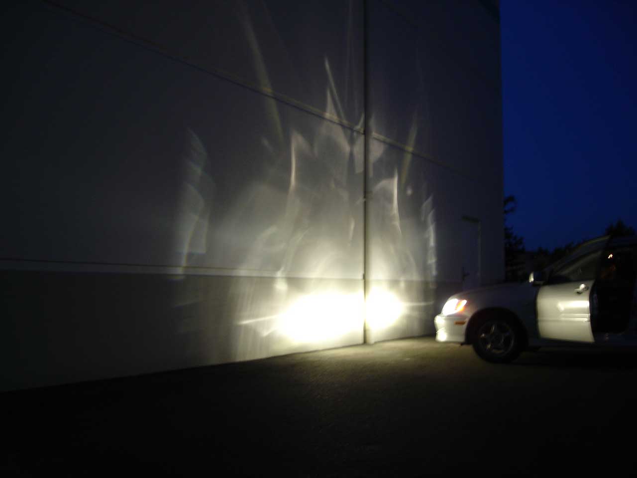

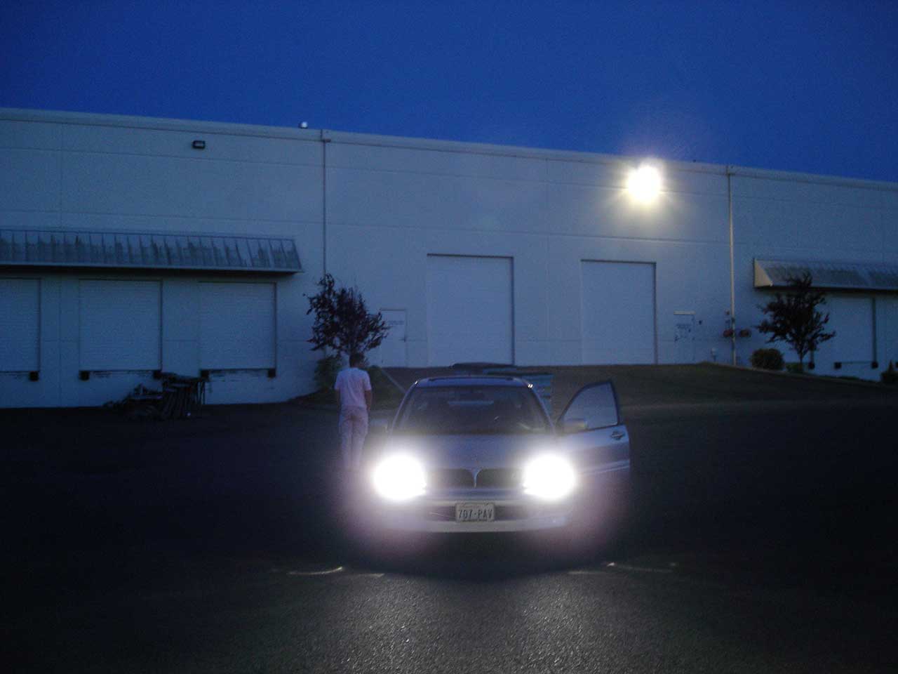

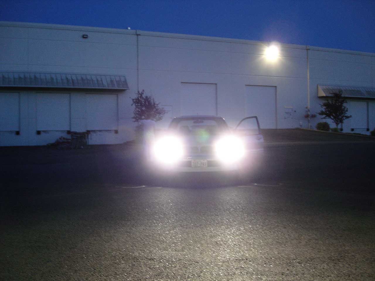

ok, I figured I would post some before pics so people can see why you should NOT USE HIDS WITHOUT PROJECTORS! I really just noticed how much glare these things had the other day myself, doesn't bother other cars because mine are aimed so low, but this is what is causing people to blind other and what makes HID's so unsafe to use if you are not responsible with them.
so whats the morale of this story? maybe once I get these installed we will have a better idea of what needs to be done for the lancer to make HID conversions a bit more affordable, I am doing this not only for me and the other drivers on the road, but for the lancer community! ill keep this thread updated as I get more updates. I hope it will help educate others a bit more.

what tempature are your HID's? they dont look very blue on the reflection on the wall. like maybe 4000k? or something?

4300k. bulbs and ballasts are phillips. The look blue if you look at the housing but at other angles it looks white and even yellow so it is probably just glare making the light appear that wayl.
