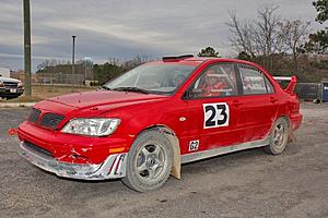

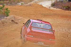

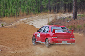

There used to be a guy on here who had a rally lancer. Forgot his screen name but I think he put tons of money into the suspension alone. I have these pics but I cant remember the thread I got them off of. He was also N/A.
Attached Thumbnails Rallycross?-rallylancer.jpg   Rallycross?-rallylancer1.jpg   Rallycross?-rallylancer2.jpg   Rallycross?-rallylancer3.jpg

The guy's screen name is Brad M. I just stumbled onto that thread yesterday. However, you won't find the one thread that is very informative if you go looking for posts with his screenname. He seems to have only started one thread. Try this: in the lancer general forum, search for "North Carolina". The thread title should read something like: " anyone know who this is ?" or something to that effect. That is how I stumbled it anyway. He also refers to a website called sandblastrally.com. I checked it out, tons of pics of him and others in action.
