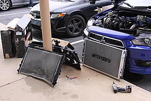

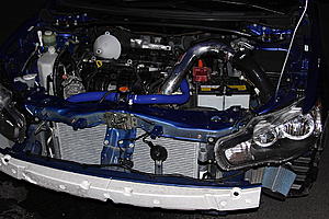

The Mishimoto Radiator fits PERFECTLY. It mounted up to the stock fans (Long story short, the store on ebay that I bought the fans and the radiator from sent me 2 radiators so I had to use my old fans). The AC condenser mounted perfectly too. The hoses had to be modified a little because I bought the Evo X silicone hose kit, but it was almost a perfect fit. This radiator is seriously 4 times the size of the stock one and you can tell its made from quality materials. It just feels better overall in your hands. I was suprised at how skimpy the stock one was, but installation overall was pretty easy. I took a lot of pics but unfortunatly my computer keeps shutting down every 5 mins so I have to post fast.

I used the Mishimoto hose kit that was designed for the Evo X. I only replaced the hoses on the top. I don't really track my car too often, only a few auto-crosses a year, but you start to notice a difference after driving very hard for a few minutes. I have a CVT transmission and occasionally I push the car hard and keep it at redline in D mode for a few seconds, or go fast, brake hard, and go fast again, ect. Usually I notice the engine isn't as responsive and doesn't pick up speed as fast after driving it too hard. With the new radiator, it never slows down after hard driving. I can keep it at redline in D mode for 15 seconds, come to a complete stop, and then break-launch the car and notice the same performance as if I didn't drive hard at all. With my old radiator, after driving it at redline for 10 seconds (or even doing a brake/gas launch) it would be a lot slower in picking up speed, and continually get slower. I haven't calculated 0-60 times or 1/4 mile times with the new radiator, but before if I did runs back to back, my times would always get slower and slower the more I tried if I didn't let the car cool down. I have a feeling I'll get consistent times with the new radiator without having to wait for the car to cool down.
I took a lot more pics but im too lazy and tired right now to upload them lol. I'm also not very good at taking pics as you can see, these pics were taken with a Canon 50D and they look like I took them with my iPhone or G1.

only the hoses on the top fit, the bottom pieces I still have in the original box in my closet lol. And for the top section they pretty much just fit in place of the stock ones except the one on the left I had to cut about an inch off to make it fit a little better. If you use a stock radiator, you shouldn't have to cut any of them.

I was concerned about the fitment around the throttle body, as it is clearly different between the 2 there.
