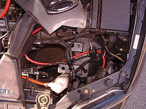

Here's where the battery use to be. Notice the big red cable coming from the fire wall ending with the connectors wrapped in electrical tape. I zip tied that in place to be safe.

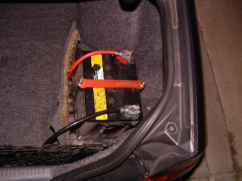

Closer shot. You can see we just drilled small holes into the floor pan and hooked the J hooks through them. It works fine, the battery doesn't budge and tech inspection at local SCCA events cleared it.

Here's a pic of the ducting. 4" ducting routed from a funnel I bolted to the bottom mud guar (could also come from the left side grill if you want)

Lightbulb
Hey did you try running the ducting behind the headlight? I used 3" dryer hose and just had to bend a little metal plate a little bit. But besides that and a little denting of the ducting it fits perfectly. AND it's not close to the engine too.
