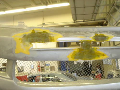

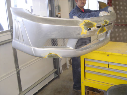

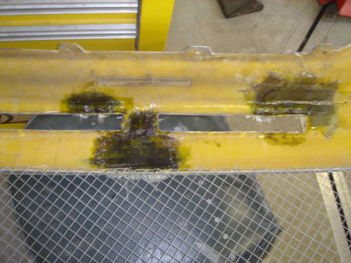

I had cracks on my Evo VII FB too. Someone back into me at the parking lot and the f*ker ran away Oh well.
Well I already fixed my bumper and it's ready to get primed and painted.
Here are the pics.
I could write a "How to Fiberglass Repair" if you guys want to.
Btw I did this on my Auto Body Shop Class.
