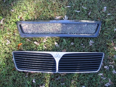

I finally got this installed today !!!
1. Start by removing six nuts and prying lose three plastic clips ( they were a PITA for me )
2. Take a small screwdriver and pry the old grille out.
3. Remove the two nuts and two screws from the new grille.
4. Fit new grille in and install nuts and screws but don't tighten them down yet.
5. Finish fitting grille into hood and snug down nuts and screws. DO NOT OVER TIGHTEN
Verdict - Cerious has REALLY done their homework on this grille. Fitment is great and it looks fabulous. 10 minute install tops.

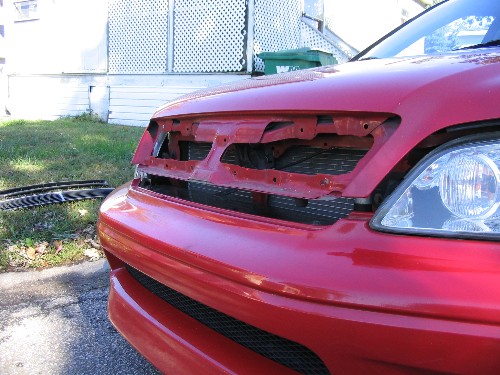

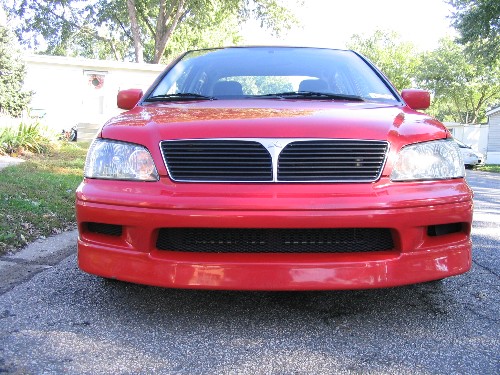

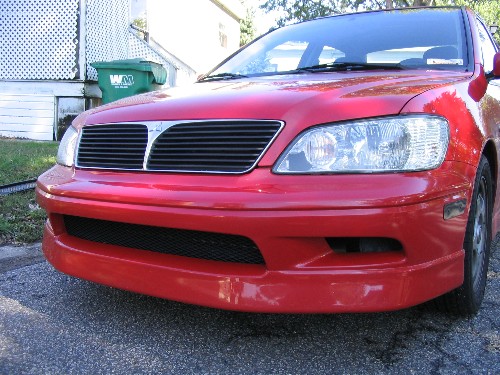

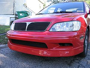

Before pics
Attached Thumbnails Cerious Performance is the SCHIZNIT !!!-lancer-grille1.jpg   Cerious Performance is the SCHIZNIT !!!-lancer-grille2.jpg

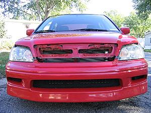

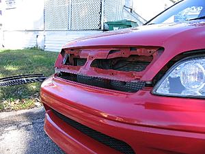

during pics
Attached Thumbnails Cerious Performance is the SCHIZNIT !!!-lancer-grille3.jpg   Cerious Performance is the SCHIZNIT !!!-lancer-grille5.jpg   Cerious Performance is the SCHIZNIT !!!-lancer-grille4.jpg

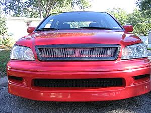

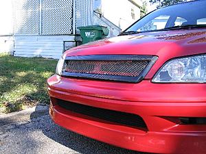

after pics
me thinks i'm gonna run to the local Lowe's and get some primer and black paint for the mesh
Attached Thumbnails Cerious Performance is the SCHIZNIT !!!-lancer-grille6.jpg   Cerious Performance is the SCHIZNIT !!!-lancer-grille8.jpg

might want to give that red bracing behind the grill a little black paint as well, but it looks real nice!

looks good.. u should paint behind the grill black
