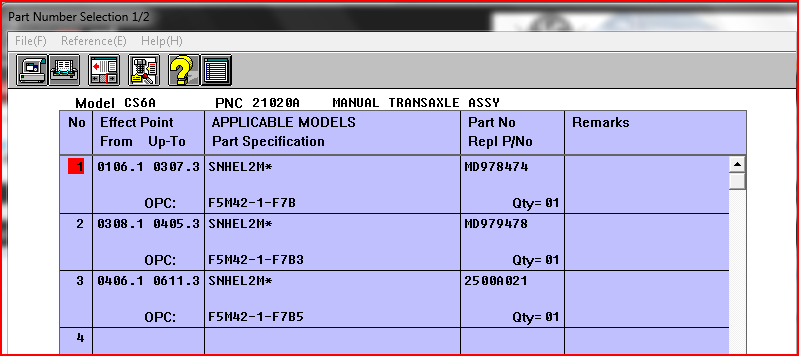

Not sure what the differences are. Here are the transmission codes if you want to investigate yourself.
